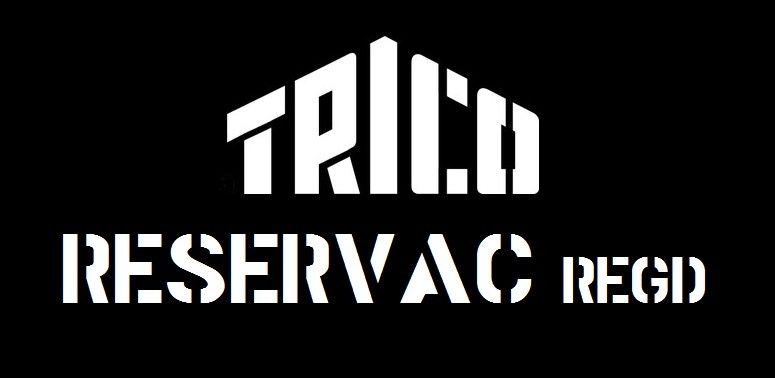

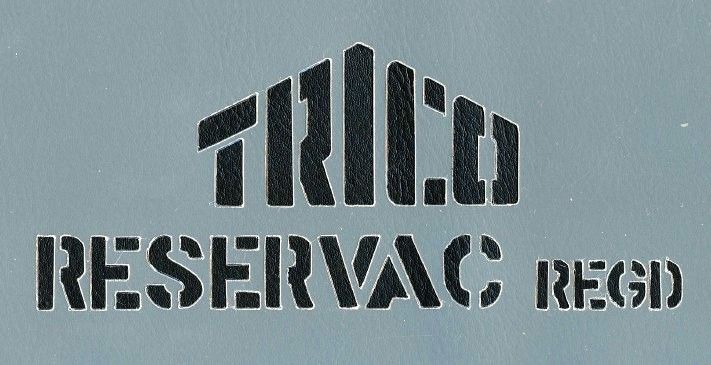

I spent a couple of hours this afternoon trying to create a decent stencil pattern for the Reservac printing.

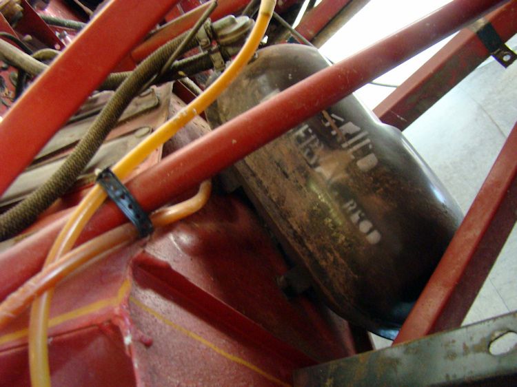

I started by using a rough tracing Jerry Mouton made of his original to give me the correct scale (Jerry misinterpreted 'REGD' as a number):

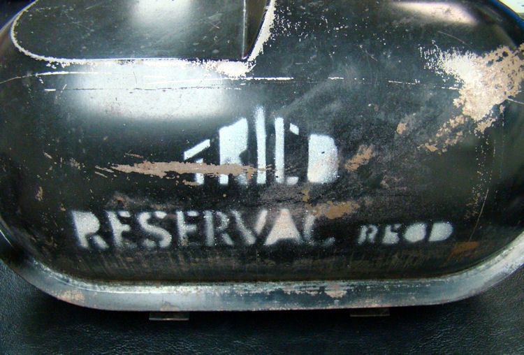

I used this restored example as a further guide and now we know the correct location:

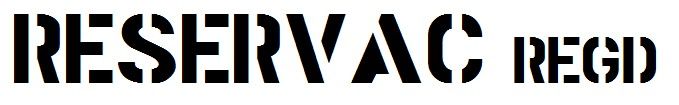

A bit of research revealed the font was 'Stencil Gothic' which I downloaded and used Word to get the correct font size (72 and 36 point) and layout.:
I then trawled the net until I found the correct Trico period logo:
I used Paintshop to add the bridges and pasted it all together:
You can download the PDF file from our Knowledge Base or here:
https://www.dropbox.com/s/0h5bzi89pmro4 ... 9.pdf?dl=1
When printed "Actual size" (do not select fit to page, scale or other option in the print programme) it should be the correct size to have a Mylar (thin and flexible as paper) stencil made. As some printers and various paper sizes can change the scale so you may need to resize the image - width of text from outer edge of 'R' and 'D' on bottom line is 6"". The quote from 'The Stencil Studio' http://www.thestencilstudio.com/ comes out as follows:
All our custom stencils are hand cut from 125 micron Mylar. Mylar is flexible, reusable and suitable for use with any type of paint. Mylar is as thin and flexible as a piece of paper, but strong, washable and re-usable. Mylar is not a rigid plastic. The price is ?15.00 plus VAT Plus P&P. Please note that custom stencils are cut to order, please allow approx. 1-5 working days to cut your stencil plus shipping times as listed above to give you a rough idea on lead times. If you need your stencils urgently then please let us know and we will do our best to meet your deadline.
Contact Clare at the Stencxil Studio if you want a copy: info@thestencilstudio.com
Stencil looks like this (not actual size which should be 6" wide R to D of bottom line):

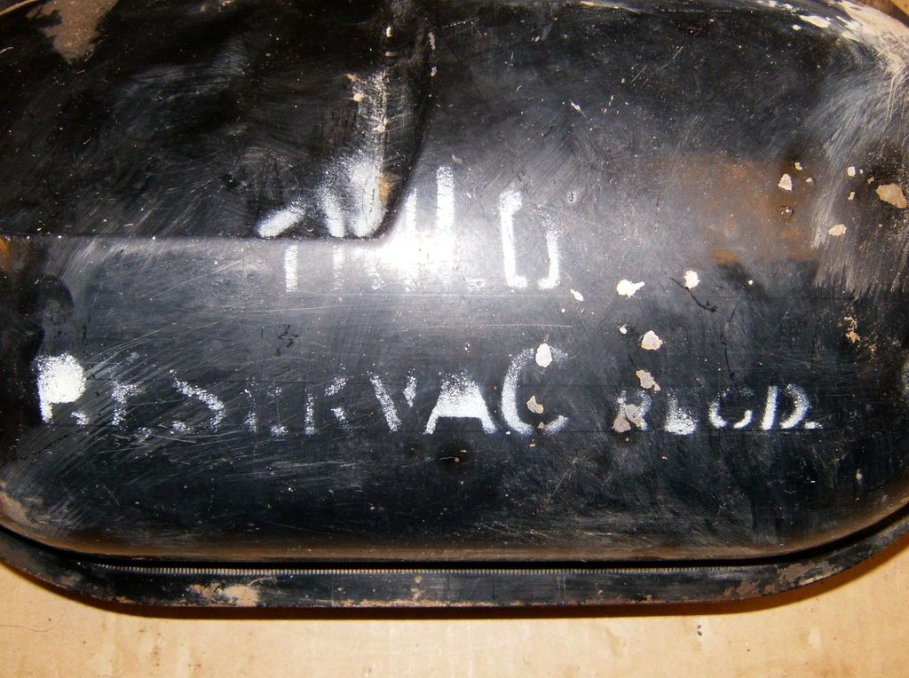

Just been sent another photo, this time unrestored:

From the look of the unrestored one, I think the only thing we can safely say is that no two were alike!

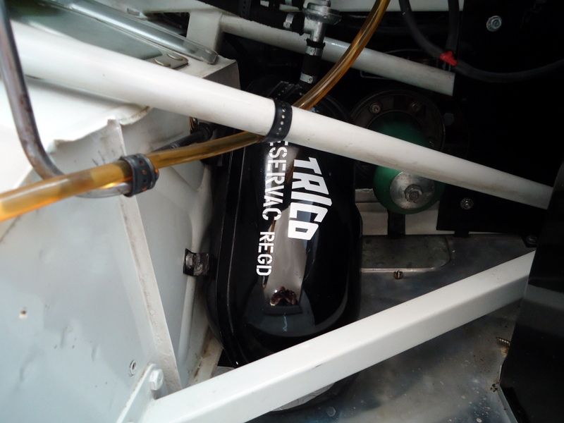

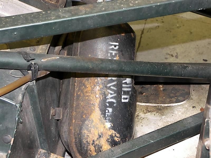

Bob Stevenson sent me these two pictures to add to our library:

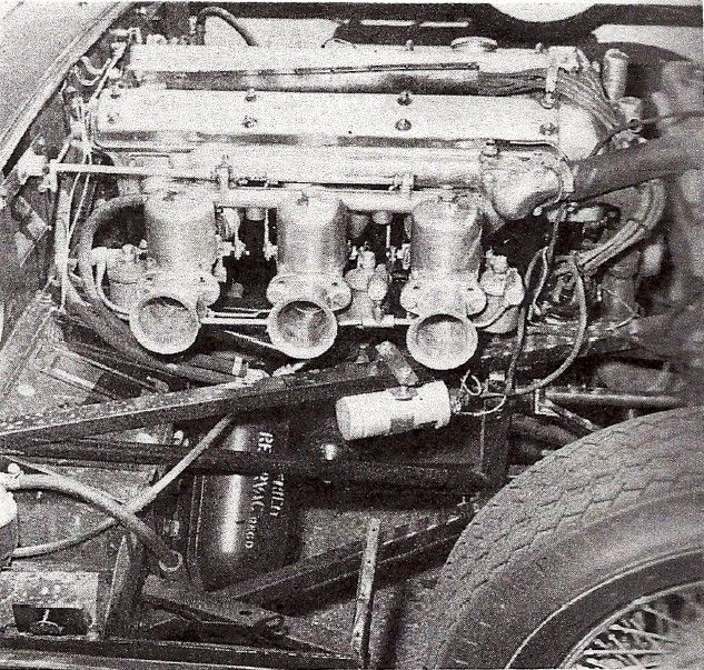

Post by Heuer » Wed Dec 11, 2013 6:30 pm
Bob Stevenson has come up with another picture, this time from 'Sports Car Graphic' September 1962 of a very early car - OSB in fact - which seems to confirm the 'Stencil Gothic' font is correct and also gives a nice view of the position and alignment:
Finished stencil should be here tomorrow so I will replace the draft version in the download link.
Question: has anybody seen this graphic on a 4.2 car?

Final stencil graphic from 'The Stencil Studio' is now available here: https://dl.dropboxusercontent.com/u/849 ... tencil.pdf
If you don't fancy cutting your own please contact Clare at 01453 731233 or info@thestencilstudio.com and they will make you one based on the pattern they now hold. Total cost will be ?22.98. Use 3M Spray Mount to attach to tank before applying paint.

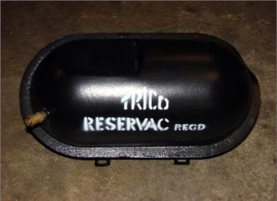

Post by Heuer » Tue Dec 17, 2013 6:25 pm
Dick Russ emailed me to say he had the stencil cut out as a decal and it was, as a result, a simple fit to the Reservac. A bit of lateral thinking there!
Only thing missing are the bridges from the Trico logo it seems.

It looks good, perhaps a little too good!
