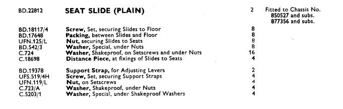

Guys, it seems my photographic record of the strip down is left wanting again, and the schematic in the parts book is not helping me. Can anyone enlighten me as to the fixing arrangement for the seats in my 3.8 please?
I just need to understand where the washers and spacers fit to be correct. And are the set screws that hold the unners to the floor pan head slots or hexagonal? Struggling to recall now. Thanks.

All the information on the build order is in the SPC:
As Harold says BD18117/4 are slotted pan head on the 3.8, pozidrive on the majority of 4.2's.

Thak you chaps for the intel. I reckon the pan head scores are NOT. Available for some bizarre reason. What is it, a 5/16 UNF. Can't be that tricky to find surely. Will a hex bolt foul the inner then?
Also. Thanks David for the detail from the parts book which I have howeve the problem comes C 18698 x 4 which is not clear where these go? I think they o on the runner stud only on the front to tilt the seat up for the tie brackets for he adjustment lever but its certainly not clear.
