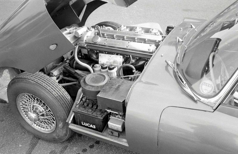

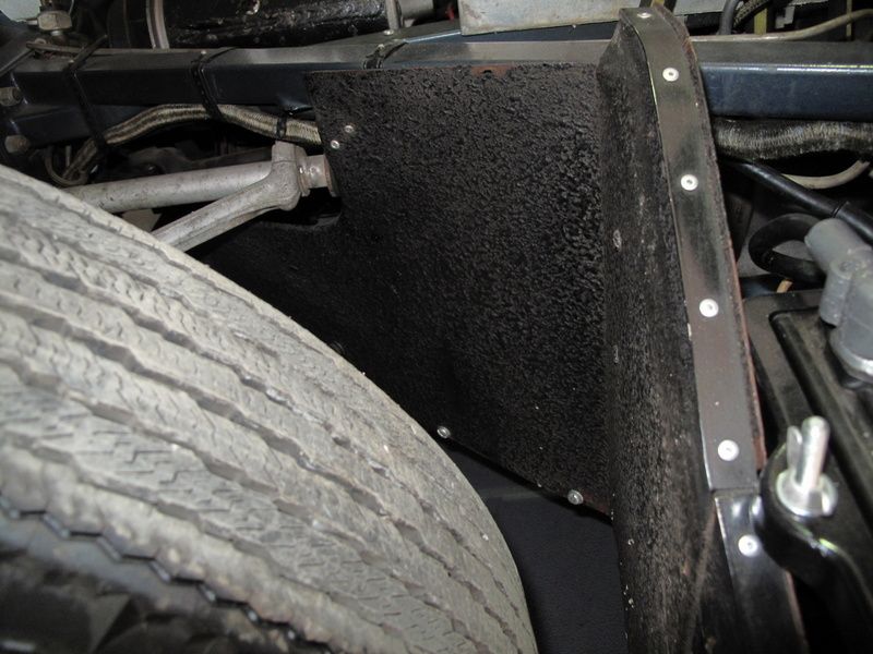

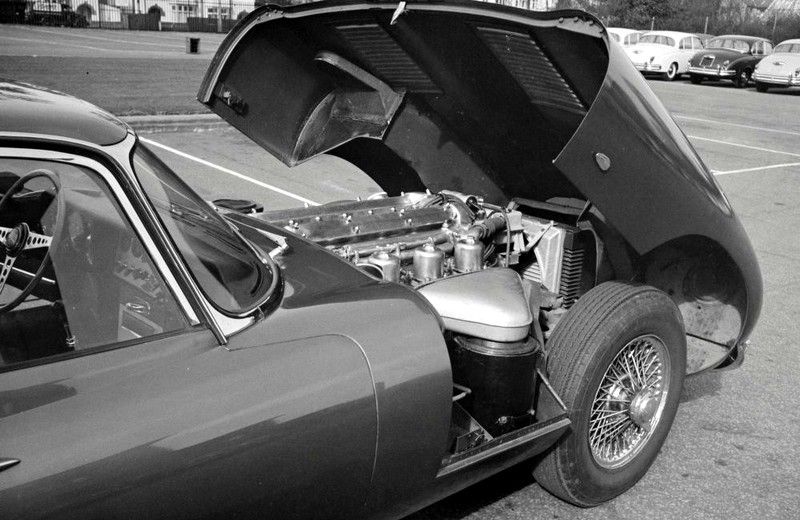

There are a few pictures in the Factory Fit thread that should help e.g.:

Thanks David,
These are great, but the problem also is getting the exact points for the holes. (my mudguards have no holes).
It is difficult to get exact dimensions from the photos, but they do show how the rubbers should be affixed.
