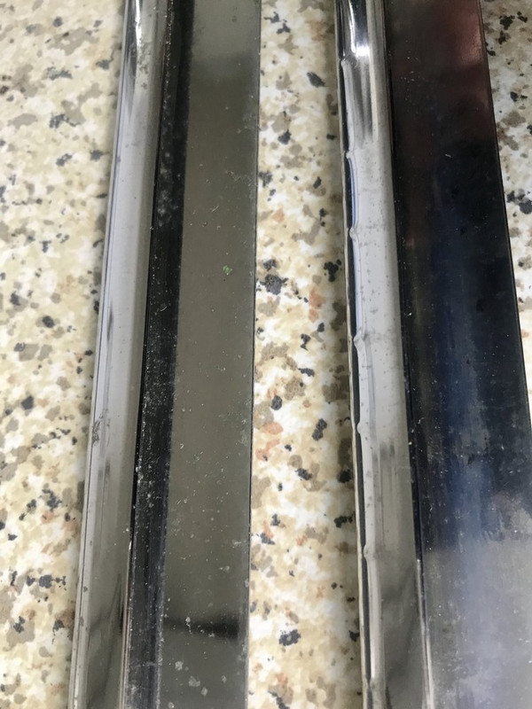

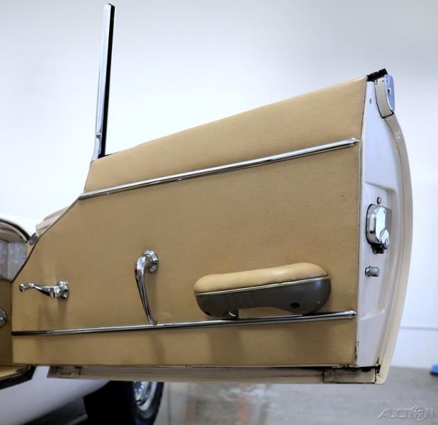

I am looking for info how the late 3.8 chrome finisher look like.

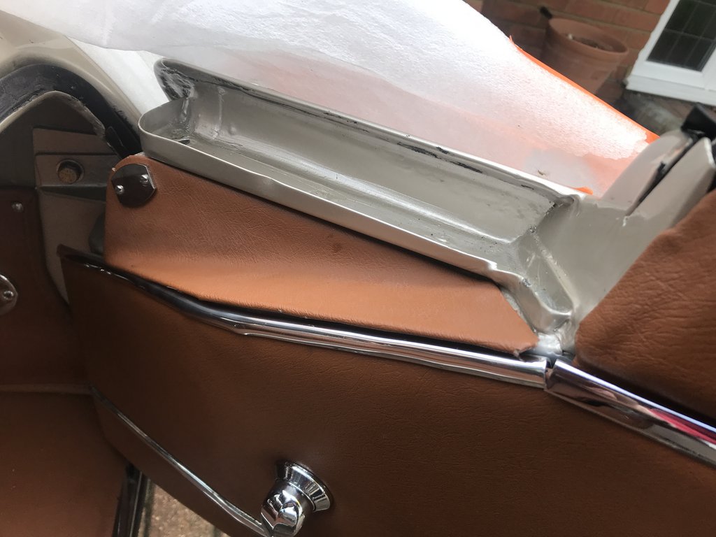

The chrome I have in mind is this one, on the front the door, to hold the door casing to the shell:
The photo above is from a 65 4.2, where the chrome is the same or similar.
You can notice that the chrome extending towards the back is the same style of chrome piece BD26542/3
The question is: is this short front chrome same for the 3.8??

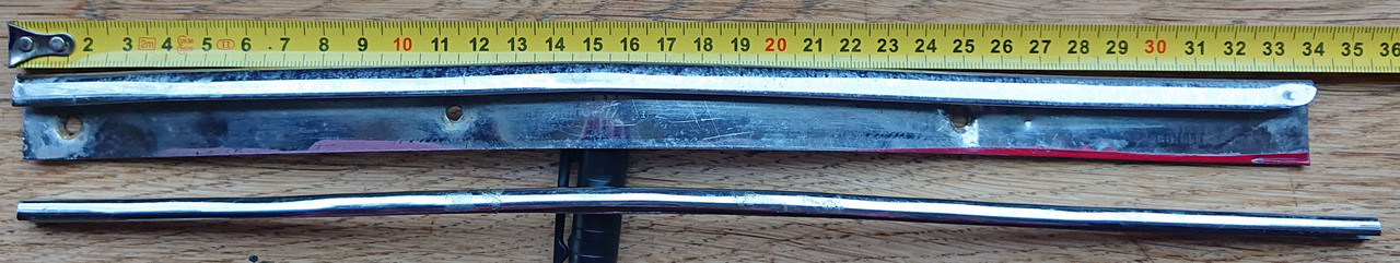

The reason I have doubts, is that I have a sample of another similar chrome piece, but that is not screwed to the door shell. Its the bottom one on the photo:
Can anyone confirm which one is correct for a 3.8 late '63 car??

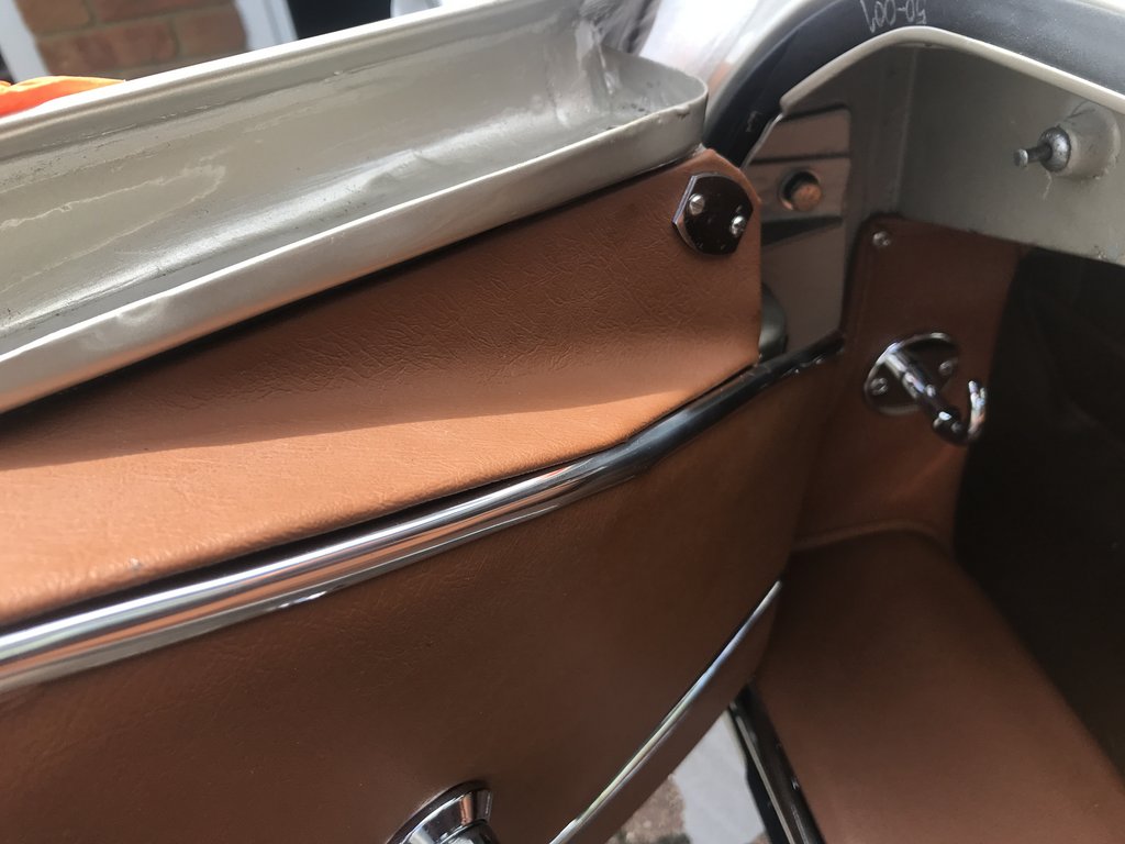

Hi Tadec, my 64 3.8 has the lower one in the photo. It is just a trim for the door panel and doesn't hold the panel to the door shell.

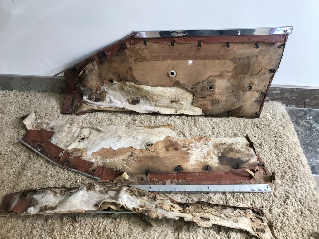

Hi Tadek,

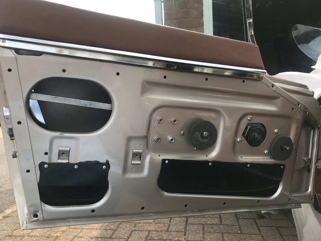

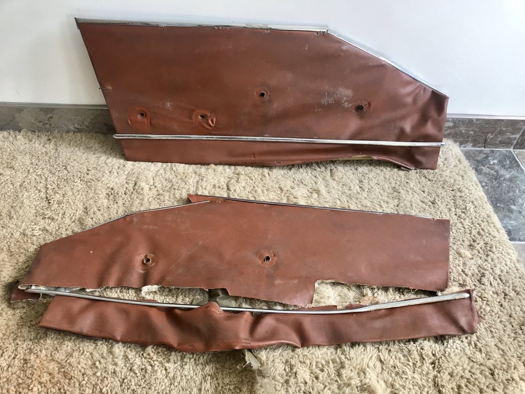

These were my door cards and trim from a Nov 63 fhc. They look similar to the two in your picture. The horizontal trim was screwed in place and the door card top edge slid into it, and the forward trim that sloped down towards the hinge, was ‘interference fit’ to the forward top edge.

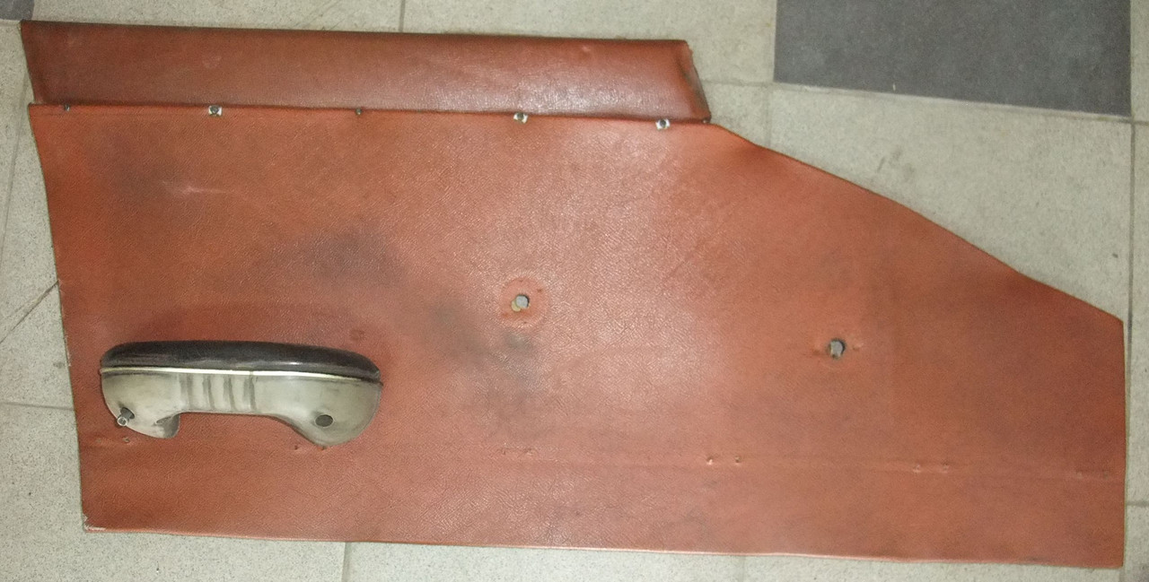

My Door casing originally looked like this:
Looking at the clips:
it seems I have the earlier style chrome trim,
but I guess I could have also the front chrome edge piece.

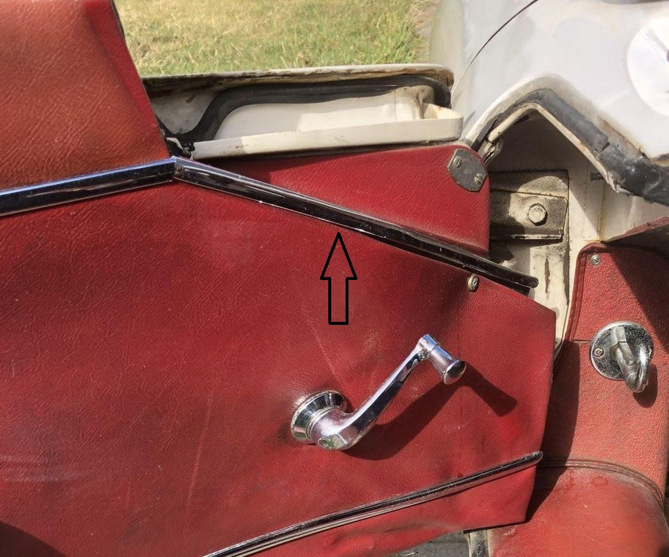

I found this car: 880472 OTS built 1st Nov '63 which clearly has early style edge trim and the forward chrome edge trim as well:
So, there may have been 2 changes:
Front sloped edge of the door casing:
up to at least Dec '62 the edge was trimmed with vinyl piping
at least from March '63 the edge was trimmed in chrome piece fitted on the sloped edge.
at lease from April '64 the edge was trimmed with chrome piece fitted to the door and the casing slid under it. This finally solved the problem of upper casing curvature.

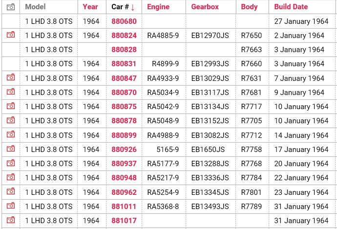

The LHD roadster chassis numbers are normally a good dating point given the volume produced and cars both before and after 880840 as listed in SPB P.109 were manufactured in Jan '64. Screengrab from XKEdata below.

Phil, could this mean that the change was earlier for lhd roadsters than rhd fhc's. 861446 is much later than my car 861316.
Derek

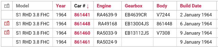

Not many RHD FHCs on XKEdata that were manufactured in Jan '64. However, those that were are period to 861446
