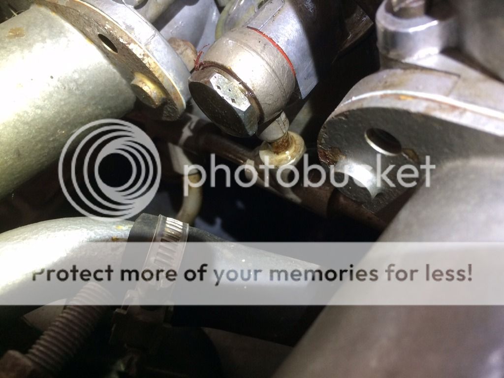

Btw, when inspecting the engine bay for kinked or squashed hoses at idle, I noticed a fuel leak ( a drip every 5 seconds!) on the feeding line of one of the carburetors. Apparently a worn seal (the small black one in the centre of the pic):
Difficult to notice when driving (apart from maybe some smell), as the fuel evaporates quickly within the hot engine bay and the leak seems to happpen only under pressure, so stops when engine is stopped...
Scaring! Needs a quick fix...

As for the fuel leak on the carb banjo, there are 2 fibre washers one on each side of the banjo. Be cautious in dosing your torque when undoing/tightening, as you could easily ruin the float chamber lid.
									There is no relay for the fuel pump (cost cutting). The external SU pump is the one that ticks.
What you have now experienced are the symptoms of a quitting pump, it would work perfect for some time and randomly cease leaving you stranded.
