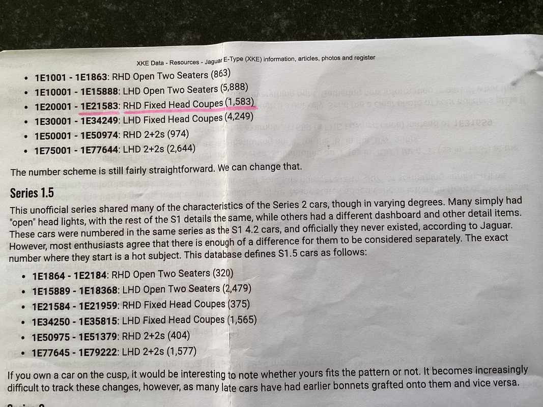

Steve at Post #3 is correct about xkedata having information.
I’m not sure on the subtlety of differentiating between Series 1.25 or Series 1.5, but I printed this out previously to find how far my car was from being one of the last Series 1, hence the underlining in that area. I note the comment on the Series 1.5, that “the exact number where they start is a hot subject !”
It is from xkedata, “XKE Car Numbers : A Guide”.

How strange and explains the comment about “the exact number where they start is a hot subject !”
My 1967 Fixed Head Coupe is 1E21525, which according to the Jaguar Heritage Certificate was manufactured on 3rd May 1967 and dispatched on the 10th May 1967 and is 100% a full Series 1 closed headlight car with full history documented all the way from the first owner.
