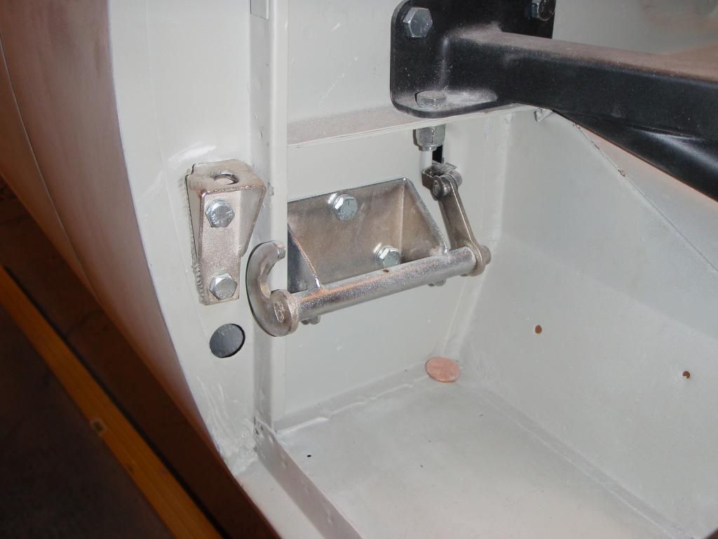

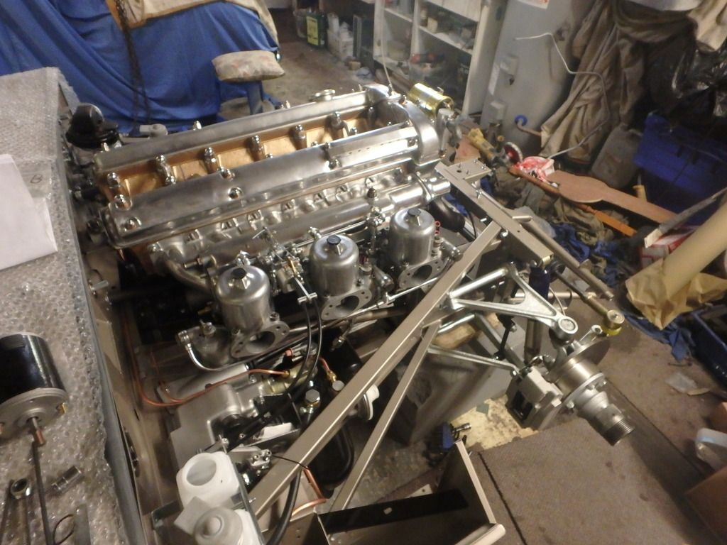

There is another option if you can find someone who does it,... dull chrome.
This bonnet latch is dull chrome;
Its quite similar to cadmium plating just slightly brighter, less bright than zinc plating which is what I did my suspension arms in as below
