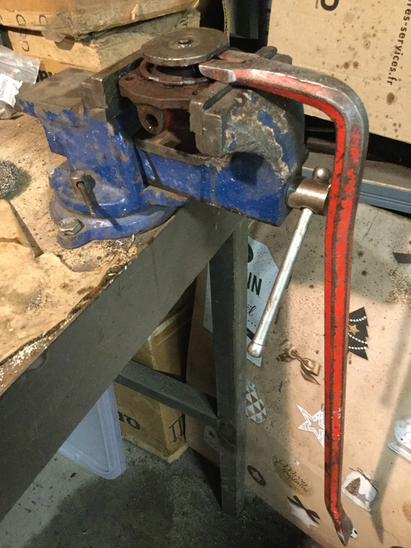

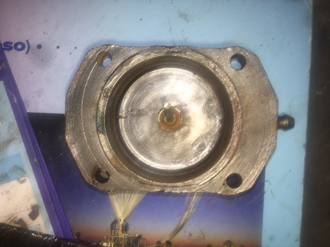

Anyway, whatever my choice they will have work to do, as I couldn't avoid to break part of the shouldered tops of the wheel cylinder when I extracted the almost sized pistons:
OK, it was a really crude way :cussing: , and it resulted in:
The machine worker will have to be well skilled.

Post by mgcjag » Thu Jul 11, 2024 9:11 am
A machine shop will re sleeve but I doubt repair that damage....Steve

Post by Philippe-J. » Thu Jul 11, 2024 9:22 am
Then I'll try to re-weld the shouldered edge prior to send them to the shop.
I know, this sounds to be quite hazardous :questionmarks: but after all these edges just hold the brake dust seals, so they don't have to sustain mechanical constrains, do they?
