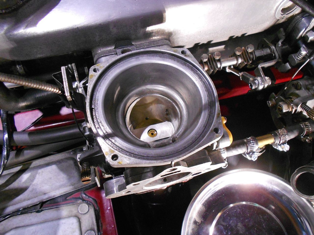

Fair enough. You may be the exception that proves the rule and/or there is something else in play.
I can't comment on the idle issue, although intuitively one would think that idle, or very slight throttle, would be the classic condition in which one would notice no change. You are right, of course, that once the secondaries are wide-open, be it through normal linkage or being wired/jammed open, the performance would be the same and removing them would give only a small extra gain on top of that.
The big benefit that I found, and seemingly everyone reports, is greatly improved responsiveness and mid-range during the transition from, say, 1/4 throttle to 3/4, i.e. normal driving. Certainly in setups employing the full crossover plumbing, it's easy to see why a straight shot of cool mixture performs better than a warm mixture forced to take the longer and narrower route. If your car has the capped-off, non-crossover system, then I could see the benefits being less noticeable.
