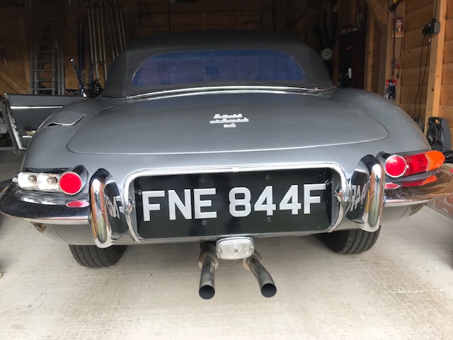

Sorry, but a dumb question.
I have an e-type 1.5 US export model but now back in UK.
My rear lights (pic below) have just two bulbs (and the reflector), one for the left/right signal and the other one is used for the brake light. Should the brake light bulb also be used for the rear night light / tail light ?
Surely it can't be just the reflector at night and the number plate lights ?

#30 Re: Turn Signal/Brake Light/Side Light.
American cars often had the brake and indicator light as one unit
That could be your problem
#31 Re: Turn Signal/Brake Light/Side Light.
Take out the bulbs....look into the fitting and see how many contacts are in there...if 2 then should be a double filament bulb.....or look at wireing....do you have a wireing diagram for your car...they are in Knowledge base section....either way you should have correct lights for UK use so need to be sorted....Steve

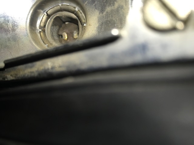

Just looked inside the brake light holder and yes, appears there are two connections (pic below) and also the bulb has what looks like two elements.
Now I just need to work out why the feed isn't reaching the connection but at least I know what the "goal" is.

#33 Re: Turn Signal/Brake Light/Side Light.
Turned out the Side Light switch had been installed the wrong way around - grrrr.
