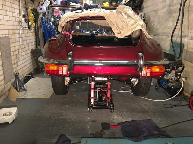

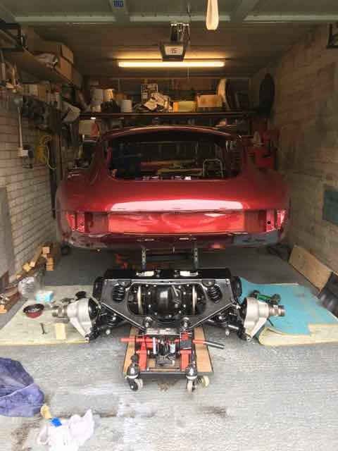

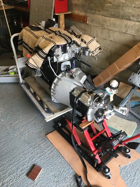

Hi Rod
I've attached a couple of photos of the arrangement I used to reinstall my IRS. I bought the 600 kg motorcycle lift [which is very useful in itself] secondhand on Gumtree for £50 and this would be very useful to remove your IRS. It's design means that the IRS sits on a very stable platform. I don't know if all motorcycle lifts are the same, but this one has castoring wheels at on end, and rollers at the other which makes moving it laterally a little awkward. To overcome this issue, I put the lift on top of a trolley with fully castoring wheels and it worked a treat, and made reinstallation very easy. I had NOS subframe mounting bushes, which I think made reinstallation a breeze as I know others have struggled with aftermarket bushes.
I don't know if any one else has mentioned this but be careful not to disturb the water throwers C20813. They're a PITA to refit.
