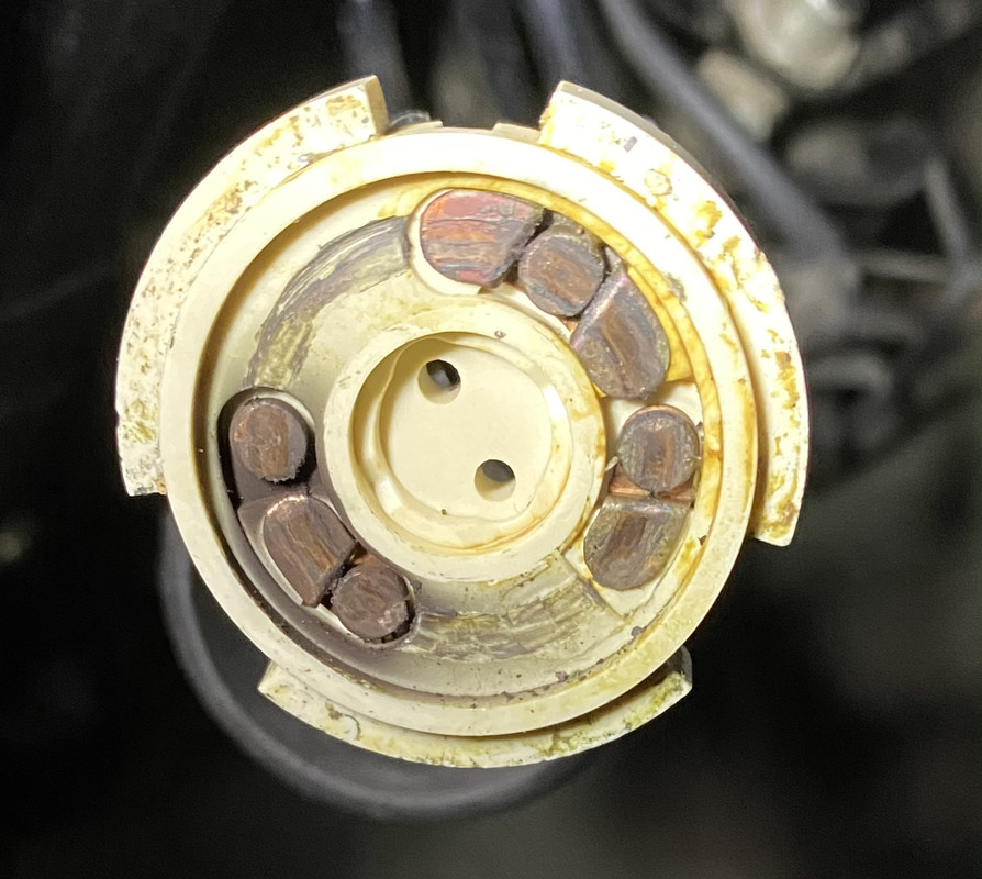

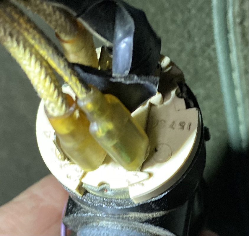

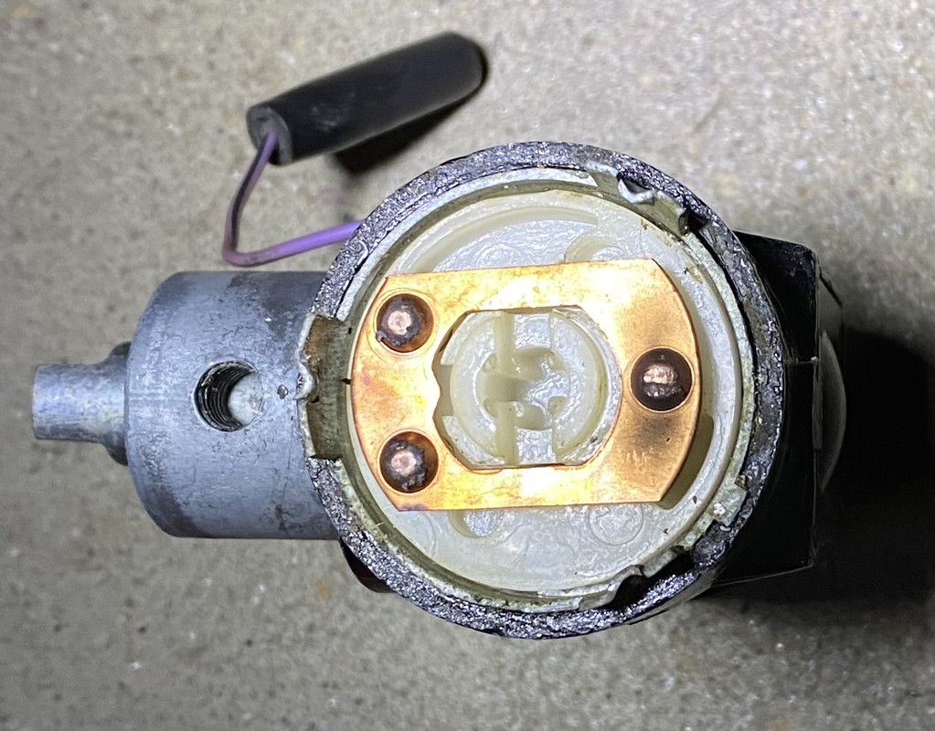

Post by cdnp62000 » Tue Oct 27, 2020 7:18 pm
Ive got the steering lock the car, leaving the back plate of ignition switch still attached to the wires. The copper plate covering the springs has some black duscoloration on the nubs. The contacts on the back plate look quite worn. I the induvidusl contacts seem to be touching in places. Is this switch to far gone? Image[/img][/img][/img]

Post by mgcjag » Tue Oct 27, 2020 7:31 pm
I would clean up all the contacts and check for short circiuts with a multi meter. ...smeer with a tiny amount of petroleum jelly...then reassemble........i would remove the complet electrical switch from the lock( held in by the tiny screw)...and remove the wires then again check with a multi meter its operation .....Steve
