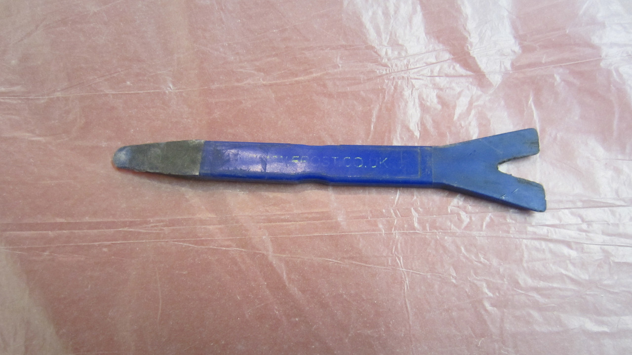

What Peter says, but I found it much easier to fit the seal with the window frame out, feeding it in from the front.
Also I recommend getting one of these:
It is hard nylon type of material which is soft enough at the edges not to damage the rubber. I have used it for numerous jobs on the interior and the windscreen rubbers.
It is much better than trying to use a screwdriver and I have found it invaluable.
I got mine as a free gift from Frost (Eastwood) when ordering other items.
Unfortunately I cannot find it on their site at the moment, but I am sure there are many more types out there.
