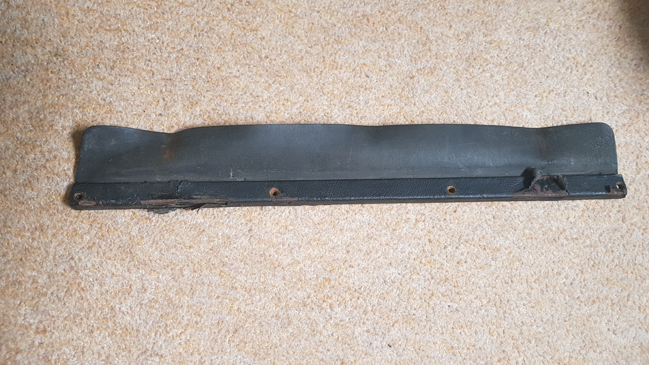

Post by Monkeyfinger » Fri Jun 04, 2021 9:23 am
Having just acquired a used S2 centre panel in order to salvage the rocker switches, I notice that there is a rubber flap and metal strip fastened to the lower edge. This has never been present on my car - can anyone confirm if this should always have been there or was added later in production? My car was built late '68.

Post by abowie » Fri Jun 04, 2021 10:40 pm
Yes it is factory.
But they get removed because they make folding the dash panel down even harder.

#3 Re: Centre dash rubber flap/seal?
Post by skiracer » Tue Jun 08, 2021 2:09 pm
I've never figured out what that flap is really supposed to prevent- a little dust getting into the radio console? I know Jaguar would never spend a pence on something they thought wasn't necessary, but I can't figure out why they put these here on the Series 1.5 and 2 cars.

#4 Re: Centre dash rubber flap/seal?
Post by Monkeyfinger » Tue Jun 08, 2021 2:20 pm
I did a bit of research and it just seems it was to cover the gap (if any), preventing unsightly views of wires. I guess I'm happy to have another original part that went missing many years ago from my car - not sure it's ever going to get fitted though!

Post by Heuer » Tue Jun 08, 2021 2:22 pm
They are on the S1 cars as well and the SPC describes them as "Light Shield (Rubber) Below Indicator Strip". Part BD24393 - title explains all!
