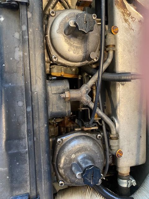

First post. Glad to find this forum. Recently purchased a '71, (built October '70) E type from local British used car dealer/repair shop. When I inquired about the pinched off tubing at the "Y" union between the carbs, (see attached photo), he said it was remnants from the emissions system, and not to worry about it. Wondering if I have the correct information, and I REALLY don't have to "worry about it." As a side note, after adding about 500 miles to this 46,000 mile car, I believe the fuel pump my be failing, as it "clicks" continually, while the engine is running.

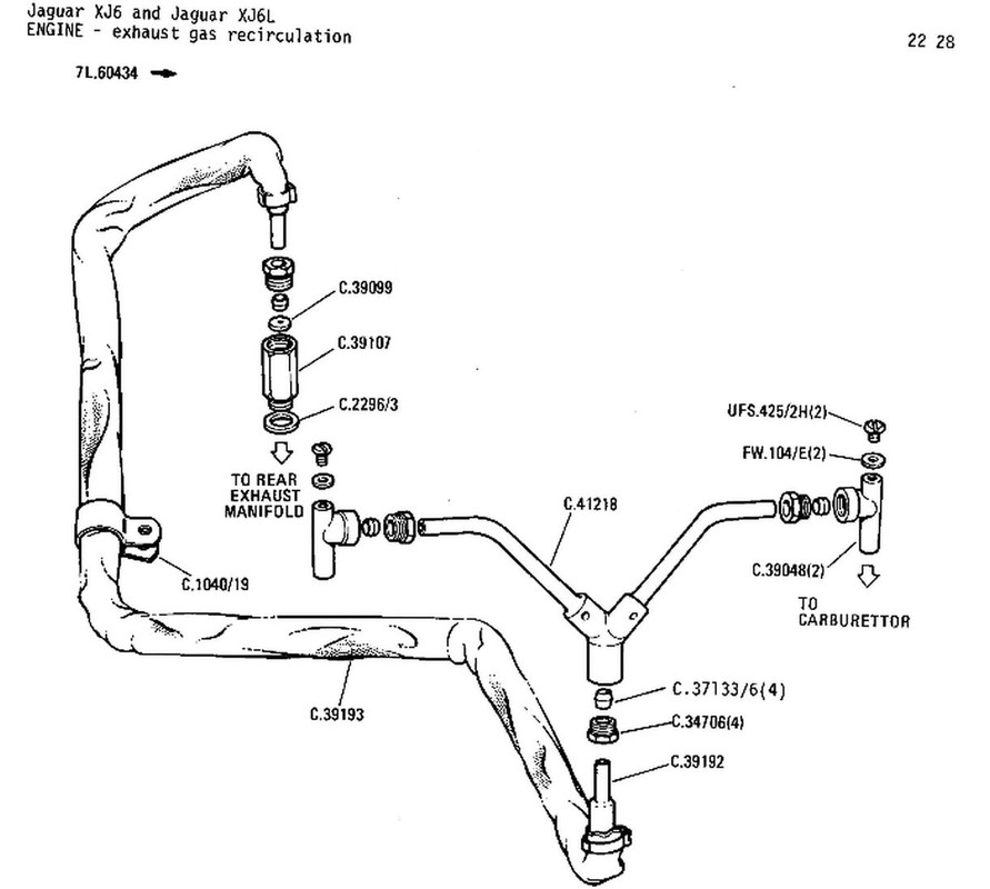

The Strombergs are not original to your S2 and are almost certainly from a later XJ6. The pinched off steel pipework was part of the EGR (Exhaust Gas Recirculation) system introduced in 1973/4 so was never used on the S2 E Type. It was used on later V12 S3s but with a different pipe layout. Ensure that there is no air leakage into the carbs via this route and probably worth checking that you have the correct carb needles for your engine.
The air filter box being black also points to XJ6 origins since the S2 E Type one was silver (unless yours has been repainted of course).
S1 and S2, unlike S3, do not have a fuel recirculation system so the standard SU fuel pump should not run continuously once the carb float chambers are full.
This XJ6 EGR parts diagram shows the same layout -C41218- as your surplus pipework, which has been rotated upwards by 90deg.
