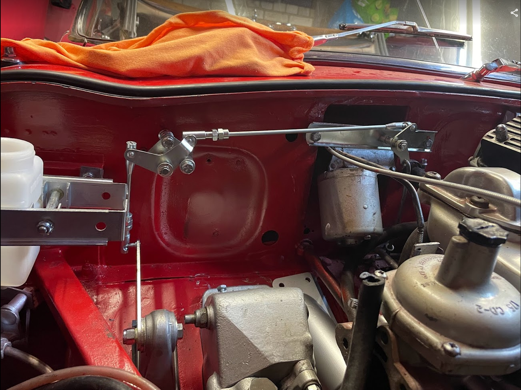

Ok - making some progress and have the pedal box modified and installed and the new accelerator pedal in also. Not plumbed the brakes or clutch in yet - clutch looks easy enough but the brakes are confusing but I will get to the vacuum pipes next...
I am staying for now with the twin Stromberg carburettors at the moment so am connecting up the new linkage from SNGB to work with my current setup. No instructions however so I am just trying to work out what goes where and what works.

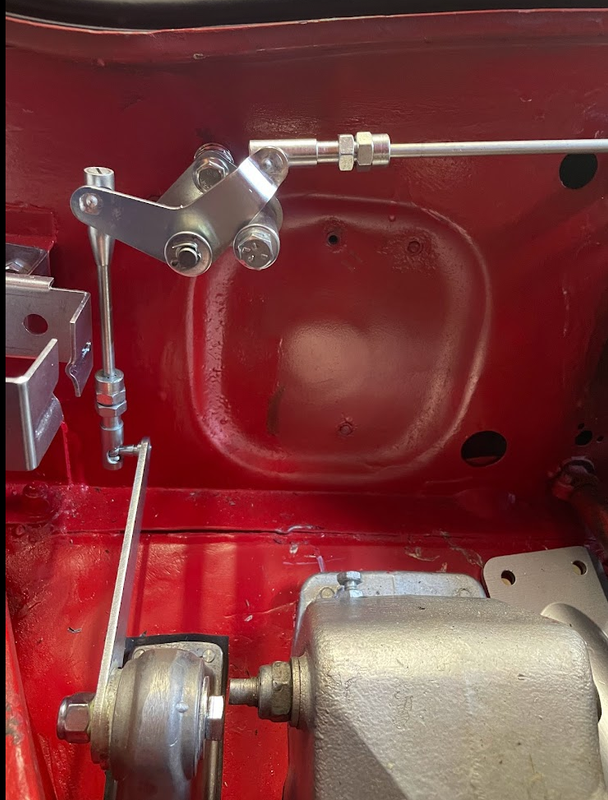

This seems to work other than then the rod from the pedal to the first 'cam' is too long meaning the pedal is too low. The rod is at its shortest so I would need to cut it to get the pedal at the correct height just a little reluctant to do this as I was told the linkage should just work with my setup so would welcome any comments if I have totally screwed this up! The first cam also needs to be spaced away from the firewall to match the second, central cam but that shouldn't be an issue - I do however only have 1 tapped hole to mount it to - the second hole does line up with the cam plate but has what looks like a rivet in it?
I have read the various articles on the RHD conversion but the main one is for a S1 and he doesn't really go into this. I would welcome any close-up pictures of how throttle linkages are on RHD cars and also any photos / info on how to connect the brake booster to the brake master cylinder. I have read I need to install 2 vacuum pipes in the bulkhead (which I have got) but I can only see what existing hole which looks like where the vacuum pipe would be rivited. A do have a lower pipe but this is connected to the large canister on the right hand side below the carbs.

Post by mgcjag » Sat Nov 26, 2022 9:28 am
Hi Chris......your linkage looks correct to me..see link for drawing https://www.martinrobey.com/jaguar/e-ty ... rhd-/26356 ..and vacume diagram...cant upload so heres a link https://www.martinrobey.com/jaguar/e-ty ... rhd-/22177 ..Steve
