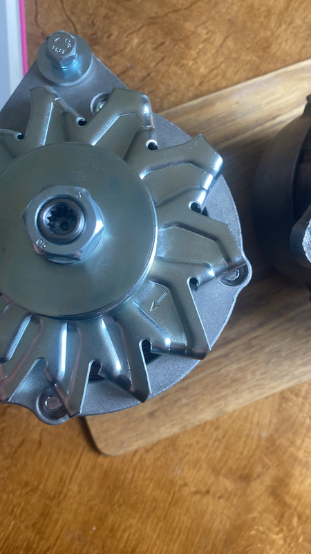

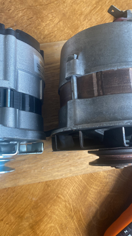

I’m not sure that’s possible. Photos attached.

In your picture there's a directional arrow that points clockwise, but your fan does indeed look like it should turn anticlockwise.

If the main body of your alternator is behind the drive belt then it is all OK. If your body is ahead of the drive belt then it is turning wrong and will overheat.
