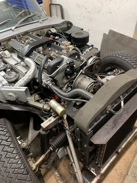

There are some pro’s and cons about fitting the foam seal on top of the radiator. What adhesive is used to fix it in place?

the foam was fitted to force air through the radiator, thus being a major part of the cooling system. After having my radiator overhauled, I couldn‘t bring it over myself to use glue or adhesive on the top box. I‘ve fitted aluminium brackets to the sides, holding the foam in place. Works fine up to now (5000 miles). The original foam I believe was yellow (-ish), the usuals current replacements are grey.

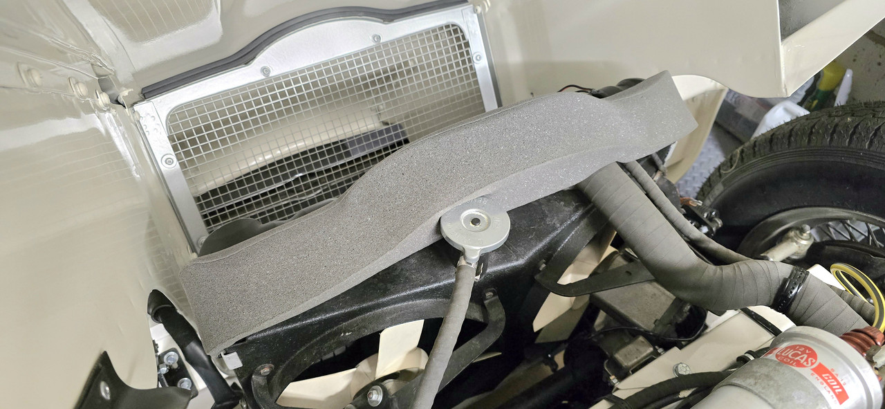

I fitted the foam as others have, using clamps on the sides of the radiator. However, I find that the bonnet closure tends to push the foam over the front of the radiator somewhat - it seems I will still need some solution to fix it centrally on the top of the rad. Anyone else find this, or is it just the final positioning of bonnet and rad in my case?

Yes, mine does just that, though I think the bonnet pushes it backwards, toward the engine. Only solution I would think of would be a new one and plenty of polish on the inside of the bonnet. Necessary ???
With that foam in place, I see little need for the felt on top of the stone guard. I don't have it and little problem with cooling.
