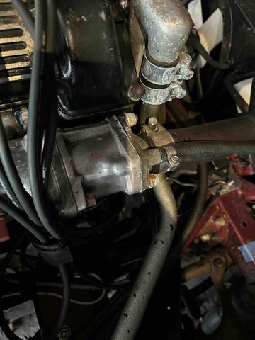

1. I am missing the foam pad that sits on the radiator. The pad is to presumably block the passage of air over rather than through the radiator. How critical is it to have this pad?
2. On my car the otter switch is not wired up. Instead I switch the fans on manually. Would it be desirable or possible to link in the otter switch (or modern alternative), and retain the manual over-ride?
3. How critical is it to have the correct thermostat for the S2 (which closes the by-pass) and is there any way of checking if the correct thermostat is fitted without actually taking it out?

1. It's not critical. It's a nice to have, especially if originality matters to you but unless you're going to push your car hard in high external temperatures, don't worry. I don't have one. My car is still on its original radiator which must have some loss of efficiency by now but I've never had an overheating problem. In stationary traffic it's irrelevant as the fans are pulling air through the radiator from behind.
2. Certainly desirable so you don't miss turning the fan on under high stress conditions. Just wire your override switch in parallel to the Otter switch and you'll have the benefit of both options. I'm using a modern replacement for the Otter switch; cheaper and more reliable.
3. If your inlet manifold has the correct extension/thermostat housing for a Series 2 then you'll have the later more common thermostat with the disc rather than sleeve bypass arrangement. Many Series 2s that started as Stromberg equipped LHD cars when converted to RHD and triple SUs have used the 3.8 manifold without the thermostat extension piece and you end up in a world of pain trying to run a sleeve thermostat which wasn't the original fit. The giveaway clue - apart from the lack of the housing itself - is an extension section in the top hose to allow it to reach the manifold.
However, when you replace the radiator you should be replacing the thermostat anyway because they degrade over time and a new one is cheap insurance for a correctly working cooling system. Also, whilst you have the thermostat housing open clean out the inevitable corrosion inside partly or fully blocking the bleed feed pipe to the radiator.
