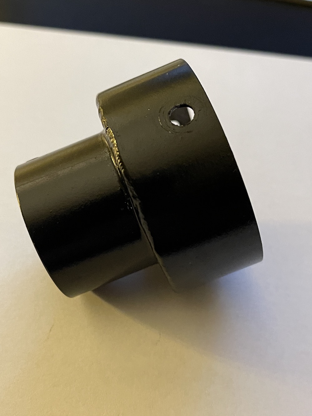

I'm not speaking for him, but I think he is fabricating the bracket alone and not the tubular mounting piece that is used on the Series 1.5. I just happen to have an extra top piece, here is a photo of it -
Hopefully, we can find a way to get both sections fabricated so that there is an alternative for Series 1.5 (or in my case an early Series 2) owner.

The S1.5 column top Bob shows above can be fabricated and I will incorporate them as Bob wishes when I receive the pattern . I will be able to offer the S1.5 bracket in RHD form - something AFAIK was not available from Jaguar as the S1.5 collapsible column was Federal only I believe . Cars which have had the aircon removed could also use this bracket - moving the ignition switch from the aircon panel to the column.
