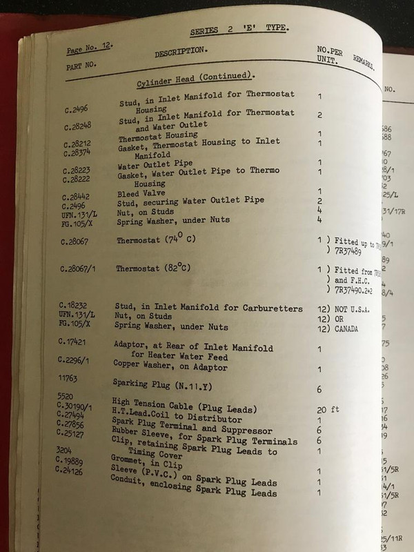

I think its the last item on this page.....
Gerry.

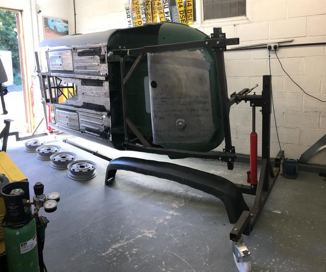

Thanks for your replies men. It seems a bit odd to have plug leads jammed up against one another like this. GM [and I'm sure other manufacturers] have been quite prescriptive about how plug leads should be separated. In particular, they specify that the leads for plugs that sit next to each other in the firing order should not sit alongside each other in the wire separators in case they track across and cause 2 cylinders to misfire one after the other. As much as I like the original look of this conduit, I don't think I'll be refitting it. Although as you can see from the photo, I'm aways off that yet!!
