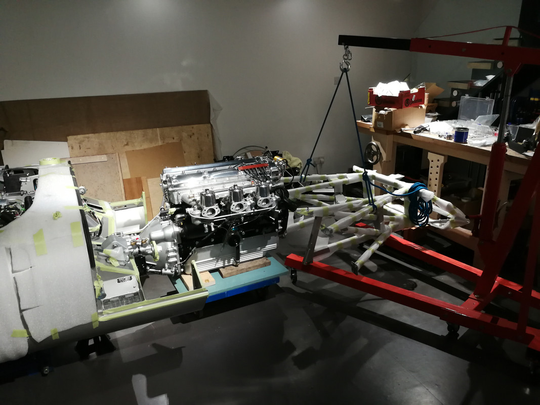

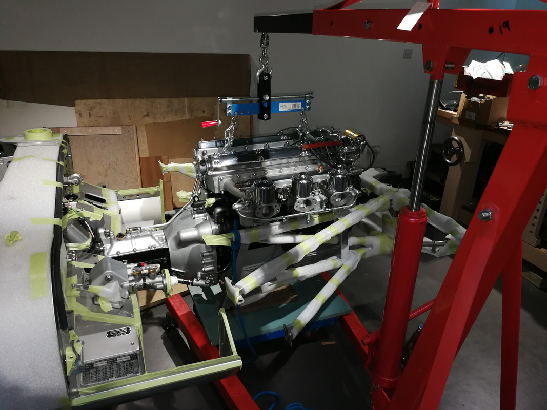

Here's how I did it. Slowly and carefully, but very safe. Step one was to remove bonnet and frames. So I did the front loom, brake pipes etc with the engine in place. I knew the bonnet would need reshimming once the engine was in and the front wheels taking the weight, so I wasn't bothered about disturbing the frames. But the engine had come back from Rob Beere with manifolds fitted and those I did not want to disturb.
Essentially I took it out exactly the same way.

#12 Re: Winter is here...
Post by Richardhealey » Tue Dec 04, 2018 9:13 pm
Hi Jeremy,
Looks like a very good approach.
Bookmarked!
