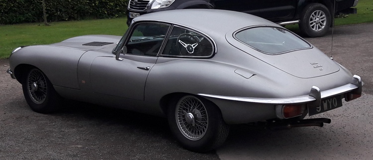

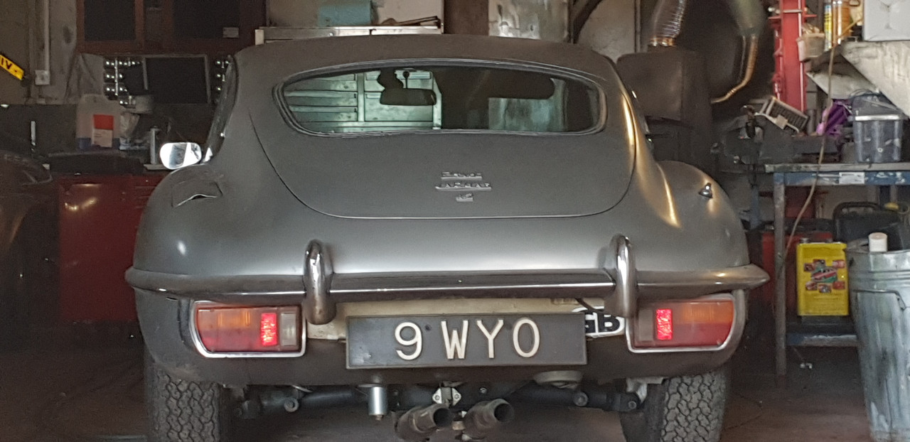

Post by politeperson » Sun Feb 10, 2019 12:56 pm
Like these ones Steve?
