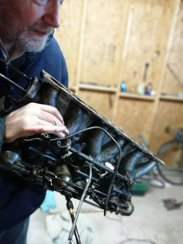

Post by JC » Wed Feb 26, 2020 5:08 pm
Rubber hammer wouldn't touch it!! Lump hamer plus wood did the business!! I took off adjacent rocker cover to allow a good angle of attack. Below - moi, looking smug. Thanks again for all the advice!!
