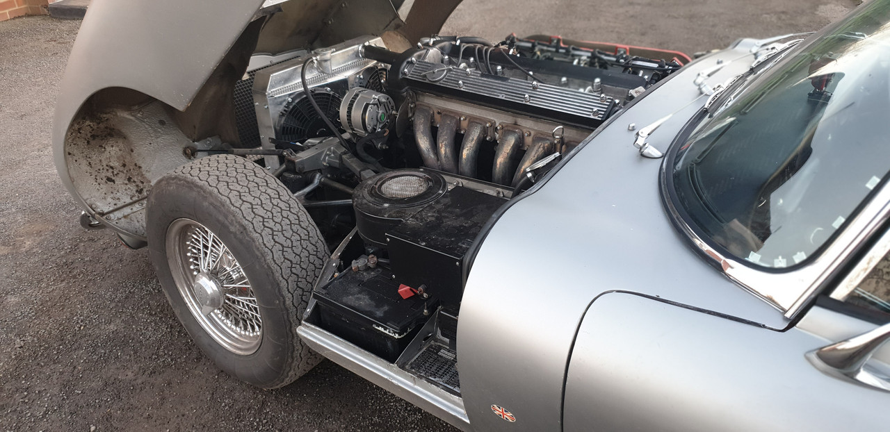

I have had my 1968 S2 since Sept 2015. It was a perfectly standard and fairly useable car but since then it has been upgraded by marque specialist Martin Lanes.
It now has Emerald fuel injection, T5 gearbox, uprated suspension with GAZ dampers, sealed for life ball joints and UJs, hydraulic power steering, Fossway calipers and discs, HID headlamps etc etc.

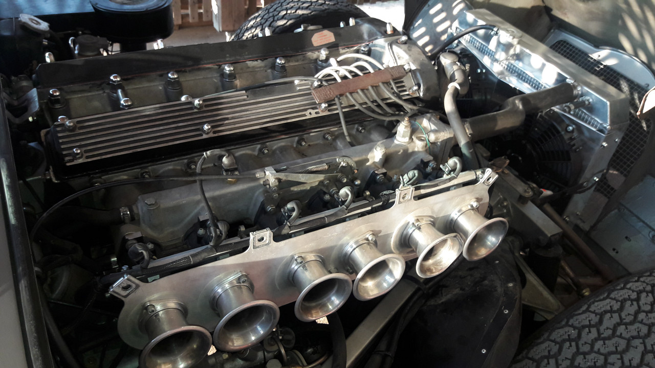

The EFI gives ~ 200 bhp at the wheels on the rolling road which equates to about 230 / 240 bhp at the flywheel. SS big bore exhaust is also fitted and makes a wonderful growl ! There is a RADTEC alumnium radiator
The EFI includes Jenvey throttle bodies and the truly excellent Mangoletsi manifold and throttle linkage - which gives excellent linear throttle control.
The car is now a superb Grand Tourer and did 2500 miles on a trip to France without problems - and resistannt to E85 fuel which the standard SU carbs are not.

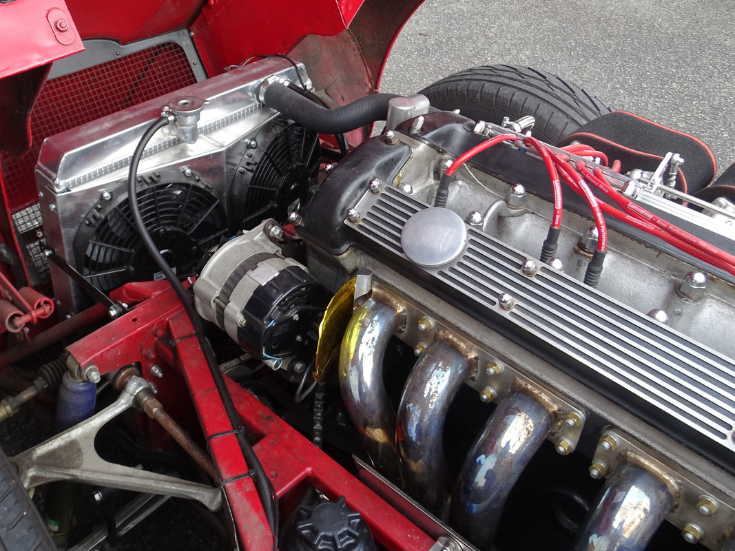

I like your mods alot.
Sounds quite much like my S2!
I have the original box and a 2.88 rear end though. I love it.
Getting around 26 mpg on Jenvies and it sounds amazing. You have my BHP at the rear wheels as well. I have a big valve head and 8:1 pistons. No oil consumption. Seems totally reliable.
