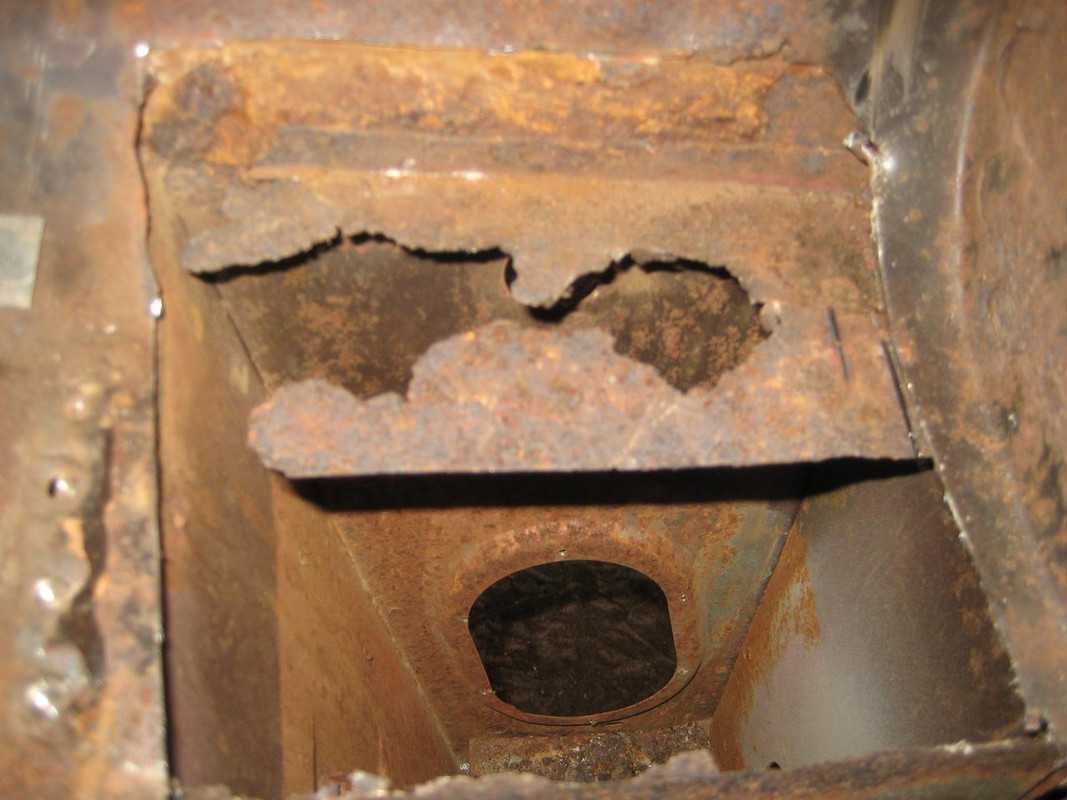

Hi Everyone
While cutting out the rot in my roadster's B-pillar, I came across this rectangular plate in the bottom. No sign of it in any parts diagrams, it is only spot welded on 2 sides: to the panel behind the door shut and the lower closing panel in the wheel arch, where it makes a triple layer for part of the seam - not a great idea. I've looked at Monocoque Metalworks excellent photos of the same area - no sign of it. Any idea what it's supposed to be doing and whether it can be left out when I rebuild? I'd really appreciate your views
Ken

Yes it is a funny little piece. In my restoration i used it to help position the new inner sill. With the car upside down the sill butts up to that panel and to the panel behind the shut face. It was a convenient piece to use to pull the sill in tightly with sheet metal screws into it and the panel behind the shut face. You want the sill pulled in as tightly as you can. I don’t think it would really hurt to delete it but it is a simple panel to fabricate so why not be correct? Sorry but I do not have a good picture of it in place.

I just checked the mm website. You were probably looking at this picture.
I agree. Itlooks like the piece has been left out so it is likely not absolutely necessary. I did find it convenient though so it is up to you.

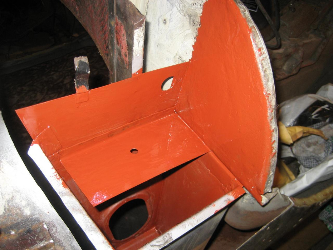

A couple of pictures if they help:
Note that the back part is sandwiched between the top and bottom panel.

Thanks, Paul, for the useful photos - they show exactly how to fit it.
