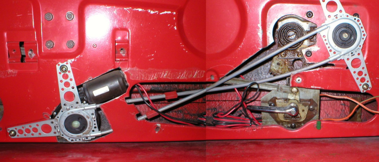

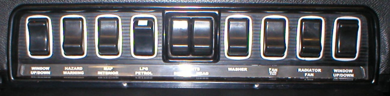

You'd have to make your own adaptation as there is no oem conversion.
Here are some pictures from my car. There is some explanatory text in the "photo albums" section of the jag-lovers.com "old site" as I have also posted there in the past.
power steering Image2.jpg (191.99 KiB) Viewed 3059 times
winder Image1.jpg (167.51 KiB) Viewed 3059 times
Strip Image1.jpg (85.05 KiB) Viewed 3059 times
The wiring has its connector running on top of the door hinge. Otter make the thermal cutout switches which you can cannibalise from an XJS.
