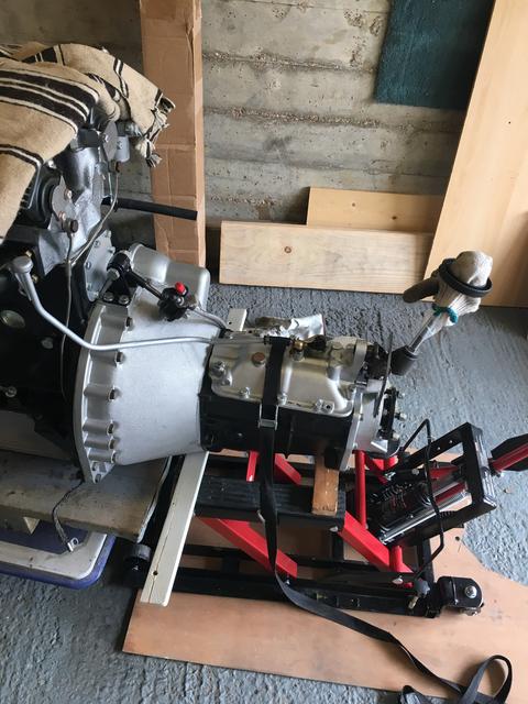

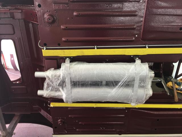

Thanks for all of your input men. I've picked up a 600 kg capacity motorcycle lift on Gumtree which I think should be useful as it has quite a big platform for the IRS to sit on. And it was quite useful when I fitted the gearbox as well.
Ash - Yes I've already fitted the remote bleeding kit.
And how lovely was it to trial fit the silencers standing up!!

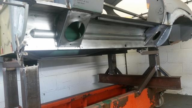

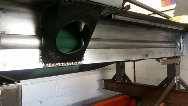

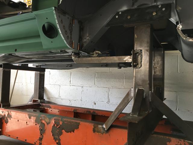

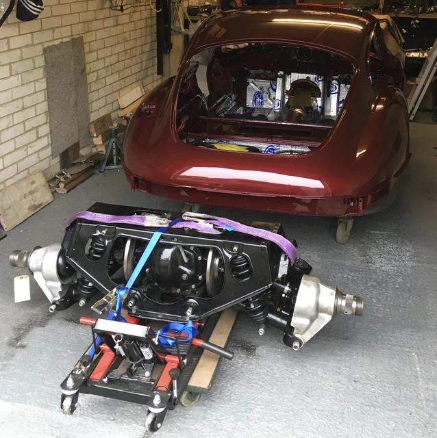

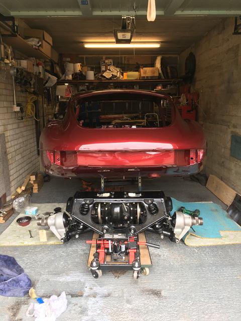

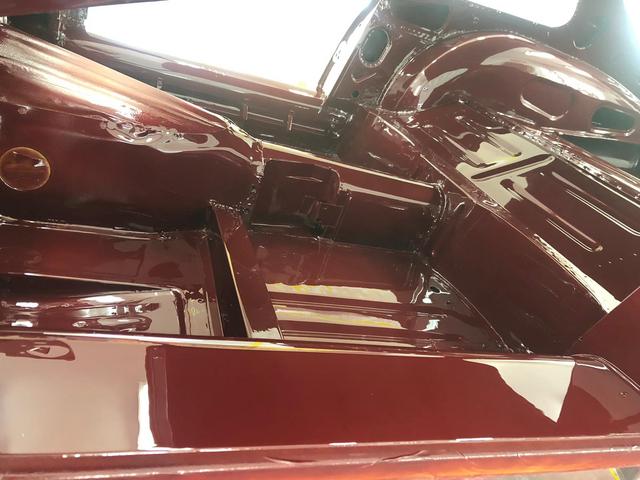

Just a quick update on my IRS which went back in very easily. The motorcycle lift was a godsend. It's one drawback is that it is designed to move in the fore and aft plane with rollers rather than castors at one end, and this was going to be an issue. So from the picture you should be able to see that I put the lift on top of a trolley with 4 castors, and then put the IRS on top of the whole shebang. I lifted the car high enough to push the IRS into position, then dropped the car down so that I only had to lift the IRS about 6 inches, and 3 hrs later working on my own it was back in. I think that my car was probably very straight to start with which probably helped. The radius arms slipped very easily back onto the cups as well. My car needed new floor sections which rather surprisingly came with the cups already installed. To make sure that the cups ended up in the correct position, once my IRS subframe had been powder coated, I partially reassembled it with lower wishbones and radius arms, and bolted it back in the car. A jig was then fabricated to locate the floors in the correct position which you should be able to see from the pics as well.
