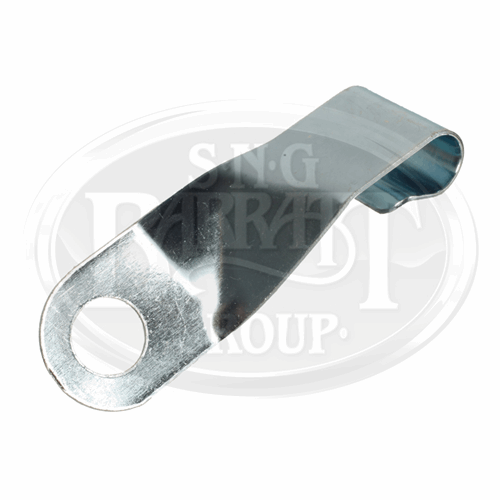

This is the top clip:
The part number of the gearbox clip for LHD cars is C18128. SNGB sell it. it bolts onto the top front of the gearbox housing. This is a LHD car:
Incidentally the original speedo cables were a beige/grey colour rather than the black that is currently available.

The parts book for the series 2 has listed the clip (c17410) and a ufs131/4r , nut and shakeproof washer . I have seen in previous postings that this clip is fixed to the rear engine mount tower. There are two holes in the lower portion of the tower.
