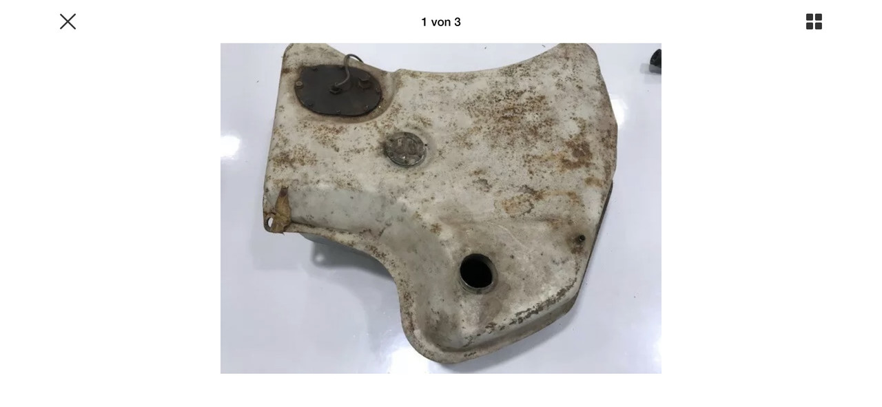

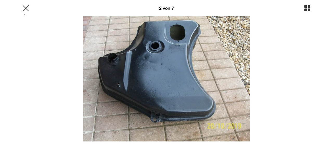

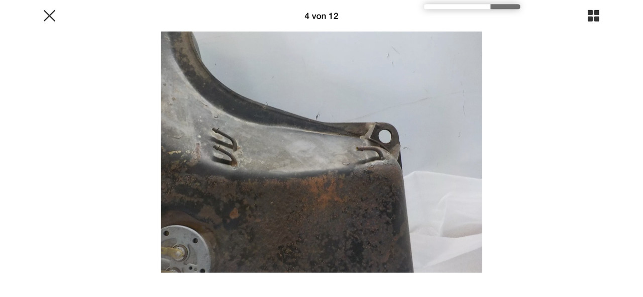

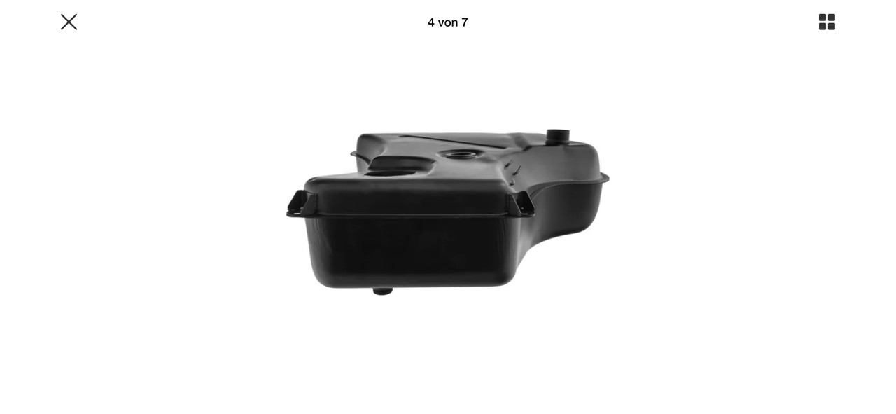

That some great information, Simon. I have scrounged a few pictures from EBay which show the differences. The first pictures show the old tank and last the later version. All I need to do now is check the filler when I get back home.
