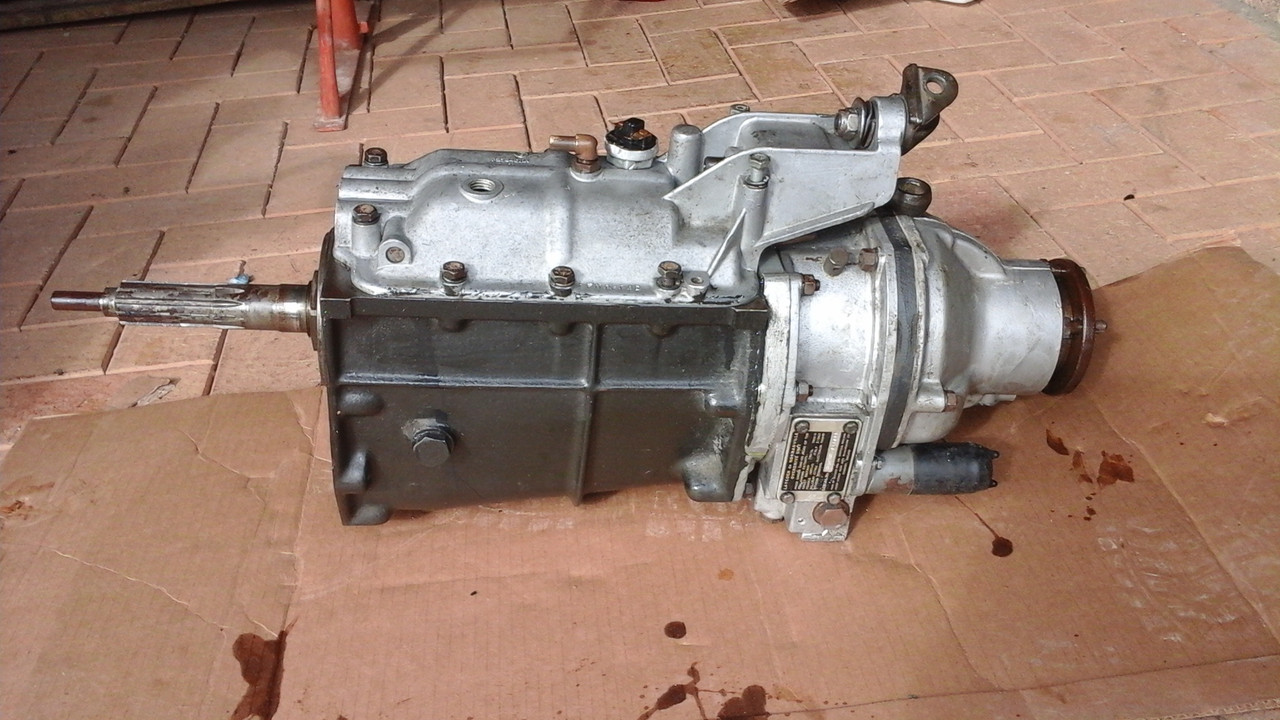

Yes, up to £1500 for a 4 speed gearbox with Compact A Laycock overdrive isn't cheap but by the time you add all the other parts you'll need to get a LT77 or other gearbox to fit and work you'll find it's certainly a cost effective option.
The Jaguar 4 speed box itself was the same for Series 2 and 2+2 cars, however when fitted to 2+2 cars the gearbox had an extension on its tail so that its extra length matched that of the longer 2+2 car and Jaguar didn't need to change the prop shaft. As it happens if you have a 4 speed gearbox with a Compact A overdrive on the end of it, as per the picture above, the length was similar to the original 2+2 4 speed gearbox and you don't need to change the prop shaft as I understand it.
Laycock made a range of overdrives and Jaguar used more than one type on their cars. The E type was never fitted with overdrive by Jaguar but folks talk about using the Compact A overdrive because that one has the most compact dimension suited to fitting in a 2+2 without bodywork modifications.
You can't just buy a Jaguar 4 speed gearbox and bolt a Compact A overdrive onto it as the gearbox has to have a longer output shaft with oil pump drive on it. Series 2 XJ6's came with an overdrive option (which is the box in the photo above) which is a good way to go but you need either the top cover from a standard E type Jaguar 4 speed gearbox or to modify the XJ6 gearbox top cover as Steve mentions to get the gear lever in the right place.
Realm Engineering offer the Toyota five speed gearbox conversion to fit in a 2+2.
