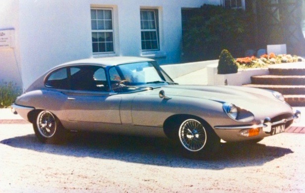

Hi All, hope your all having a great start 2020.
Some help please. I have owned my E type for 40 years, its a very rare car. One registered owner from new, only covered 50K miles from new. its original, not restored and in fantastic condition.
full history, original Bill of sale, very rare plate.
it was my intension to ship the car to Australia upon my retirement, but they have implemented a zero asbestos rule, meaning i would have to take the head off, remove exhaust gaskets, remove from tunnel also drop out the rear suspension. I think its all to difficult, so I think the best thing is to sell and purchase a car in Australia.
i would ask where people in the know think I should advertise this rare beauty for sale ?
