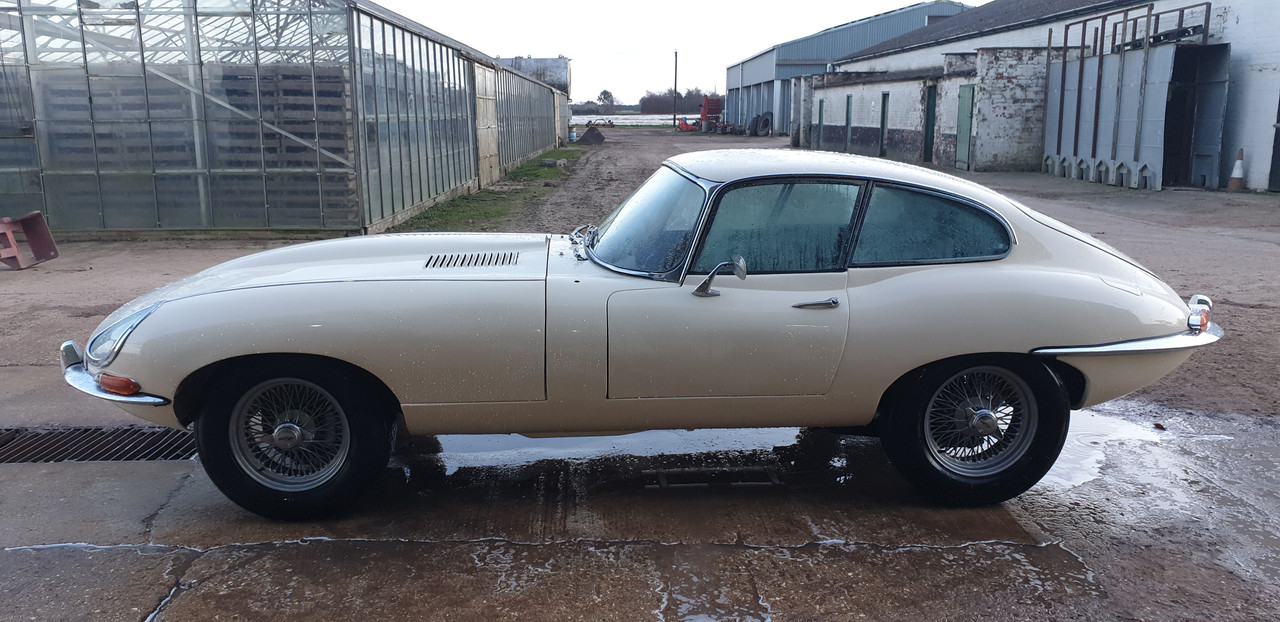

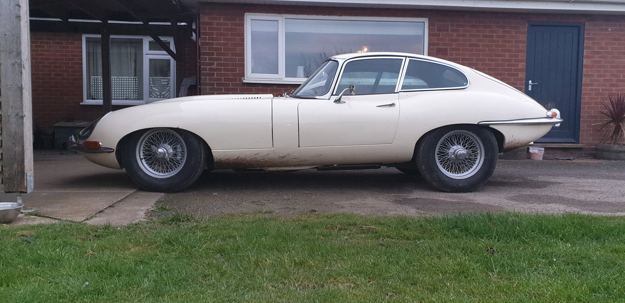

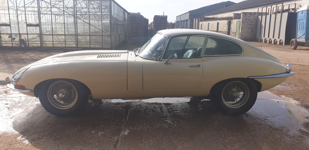

Post by politeperson » Sun Mar 22, 2020 8:47 pm
Here is one I did earlier.
55 year old torsion bars dont want to play by the book settings I find.
Stage 1 45.6mm.
Too High! At least it was level.
Stage 2.
So I thought I would be clever. I knocked the TB ears back and clicked them around one whole spline. I thought this might be a 2 inch drop. It was more!
Too low!
Stage 3. Start from scratch.
I redrilled the tool at 43.5mm.
That is where it stayed.

#6 Re: TB adjustment tool again.
Post by Pex » Mon Mar 23, 2020 7:03 am
Number one looks like mine, Maybe this will not be as easy as I thought.

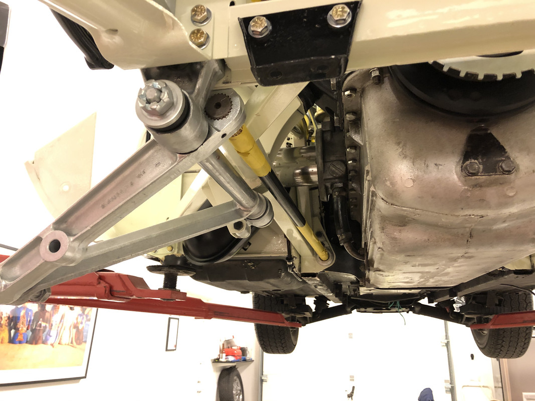

#7 Re: TB adjustment tool again.
Post by Pex » Tue Mar 24, 2020 10:04 am
from my restauration thread:
Managed to get the TB’s in place, much more work than expected.
Checked the old markings I made and they ended up measuring 44.5 cm on the right side but 45.5 on left side? so I decided to keep it 44,5 on both side for now.
I had got the impression that it was possible to move the TB when the adjustment tool and the drop shaped bracket was in place but no. The TB wasn’t in a straight line between it’s mounting points so I had to have to set the lower wishbone horizontal, parallel to the floor to be able to loosen and turn the TB and then press the drop shaped bracket back in place again.
At least both side have the same height now.
//Peter
