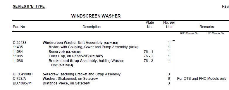

here is a pic from my S2 of the washer bottle bracket.
Bob F

#4 Re: Expansion tank bracket dirctly against bulkhead?
Post by Pex » Tue Feb 18, 2020 5:55 pm
Perfect, thank you... exactly what I needed.
But now I see that I'm missing more parts :scratchheadyellow: I only have the L shaped back part and the bottle.
Only seen complete brackets so I probably have to buy such since I also need the strap.
Is there any name or product code for the distances so I know what to search for, or do I I have to manufacture them? Also,if someone know where to buy a separate strap or/and the the horizontal bracket , please let me know since I haven't been able to find any dealer inside EU.

#5 Re: Expansion tank bracket dirctly against bulkhead?
Post by Bob. » Tue Feb 18, 2020 6:30 pm
Distance piece on setscrew - 3off BD18957/1. SNGB list them.
Hope this helps,
Bob
