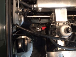

Hi guys, my 1969 FHC remote starter solenoid is located I believe in an odd place. It’s on the right side fire wall shelf below the wiper motor and windshield washer device. Is this the original location? I’ve explored all of the on line engine photos but can’t find one that reflects the original placement. Any photos would be appreciated. Thanks.

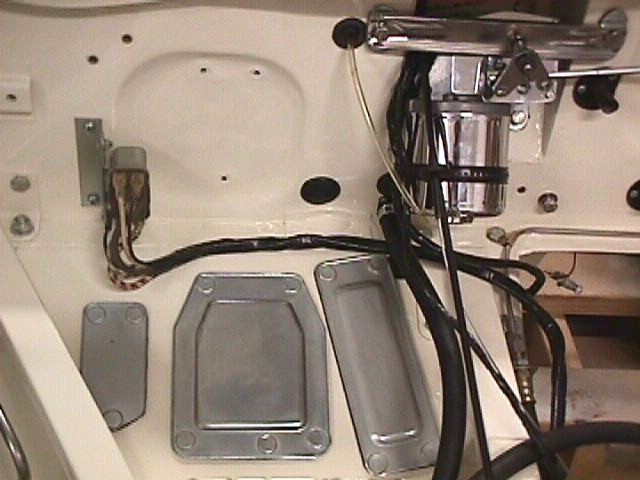

Hi Allen,
On later S2 cars the starter motor relay is mounted on the bulkhead as in the picture below. I have also seen a different bracket arrangement but again on the bulkhead. The change coincides with the addition of a ballast resistor.

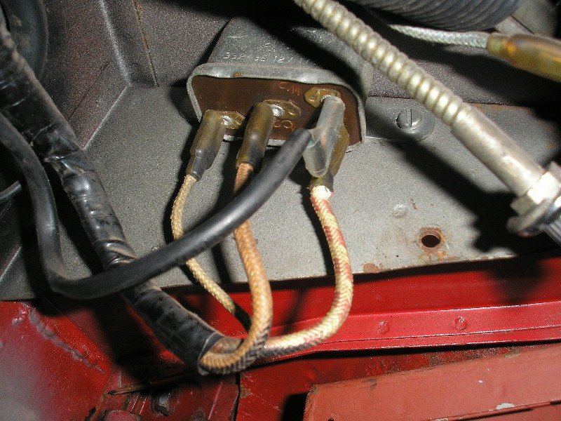

Earlier cars have the starter relay mounted inside at the bottom of the screen pillar as in the second picture.
Both pics courtesy of Jag Lovers.

Post by mgcjag » Fri Apr 17, 2020 10:27 pm
Hi....the relay is as Simon posts above...but on a 69 S2 the starter solenoid is mounted on the starter motor....there is not a remote solenoid.....Steve
