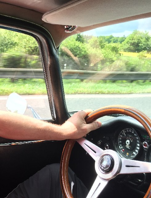

Hi Greg,
yes, I have fitted smaller diameter nardi steering wheel with this hub https://www.ebay.de/itm/Nabe-Lenkradnab ... SwrklVHTdf
Looks quite good in black. Nardi wheel photo:
best
Pavel
