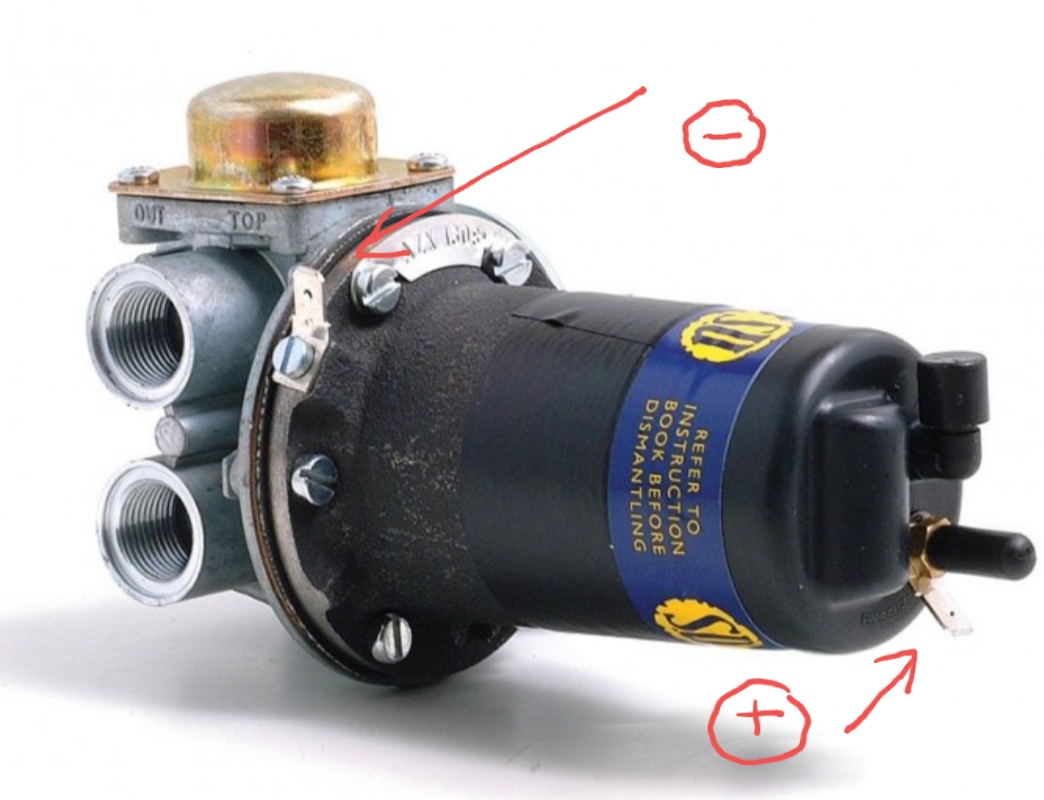

I'm going to give that a try tomorrow with the screwdriver. Also, do you know which terminal on the unit is the earth (ground) ? Mine has one terminal in the rear and one in the front. I'm wondering of the previous owner disconnected it and reconnected the wires incorrectly because it was running when I bought it 6 years ago. What do you think ?

The terminal on the end of the pump is the positive. The terminal on the metal body of the pump is negative.
You say you have already tested the 12v positive supply and that is ok. I would also check you have a good earth

I tried tapping on the pump to get it going and nothing happened. I again tested the wires to the pump and there is 12.8 volts power when the ignition is turned on and the wires to the pump are connected correctly. I just removed the pump and it was completely dry. So I will be getting a new one from Barratts USA here.
Thanks for your counsel.
