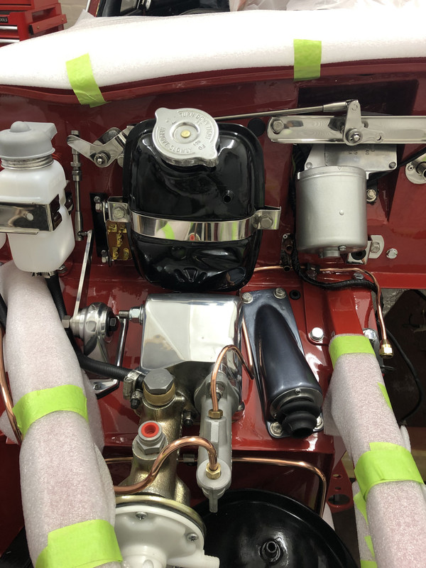

#5 Re: New Member ..LHD to RHD conversion.
Hi Phil,
Please find attached a pic. of my original rhd roadster firewall. I can send you other pics. if you want any further info.
Greg
Greg

#7 Re: New Member ..LHD to RHD conversion.
Thanks Greg.
That was just the photo I was looking for. If you don't mind, I'll take you up on your offer of more photo's once I make a start.
Cheers Phil.
