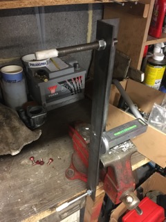

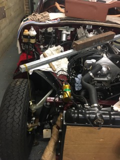

When rebuilding the car, I fitted the fully adjustable upper fulcrum shafts. So, no need to jack the car up at all. What I did in the end was to set a plumb line just in front of the wishbones so that I could measure when the steering axes were upright. Having got the steering axes perfectly vertical I then wound in 2° of positive castor. 5 turns of the fulcrum shaft or counting 20 flats as I did. Turning the adjustable shafts alters castor and camber at the same time so I then measured camber with the gauge that I had made up and tweaked it until it was 1/2° neg. I'll drive the car for a while and see what it's like, and then check it again when the suspension has settled in.
