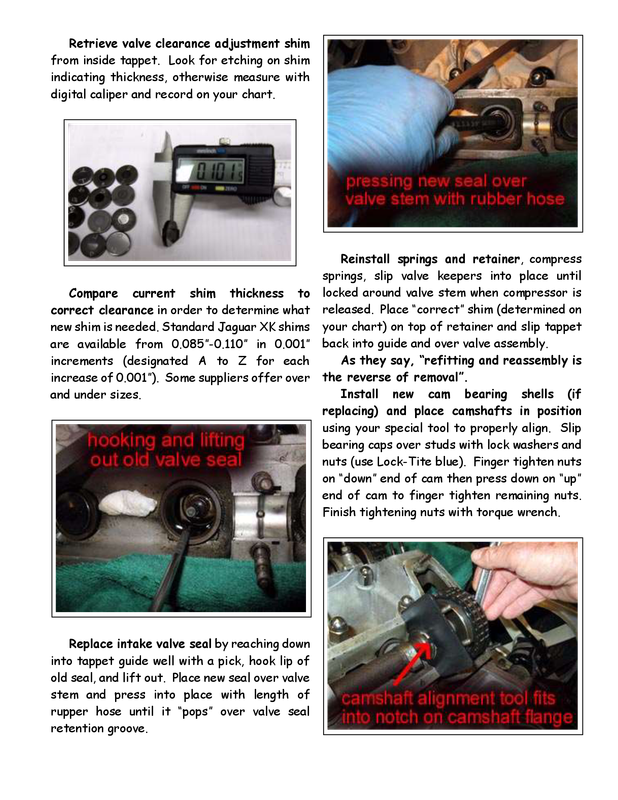

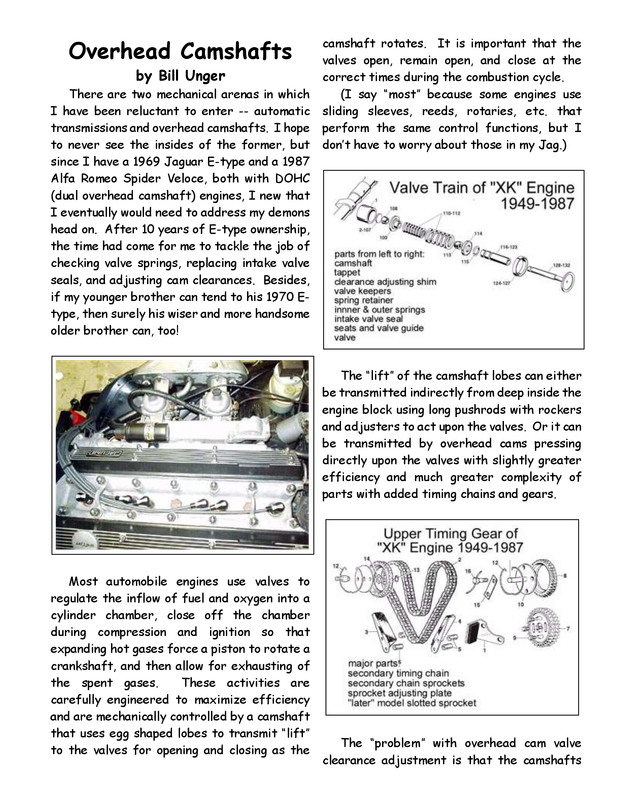

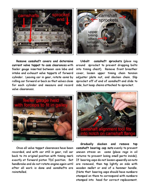

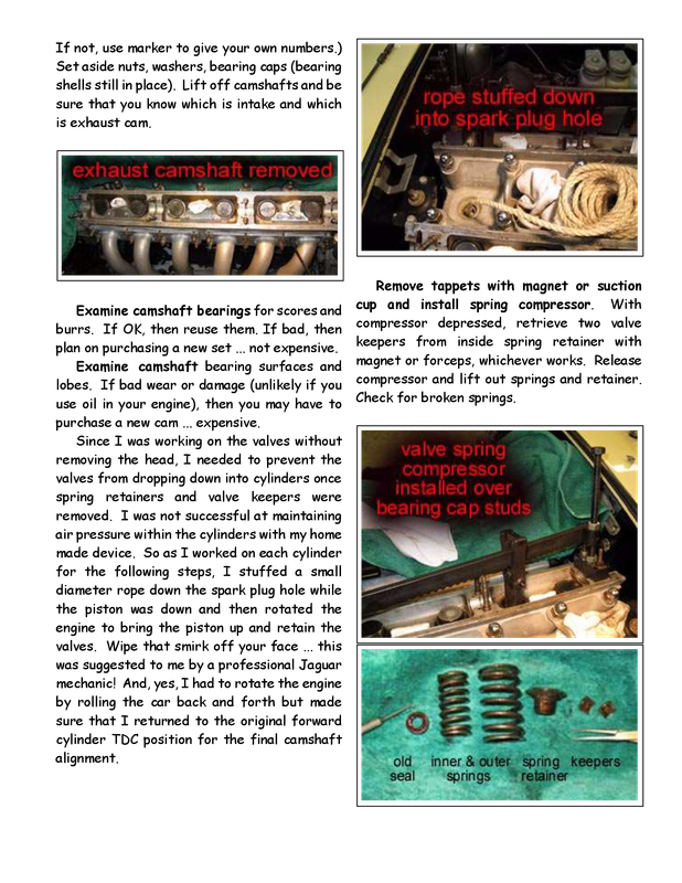

Jose, yes, it is easy to do with the head on the engine. Basically, remove the cam covers, detach the timing chain, lift off cams, release valve keepers, replace seals (intake side only). Reassembly is the reverse. Of course, this is way simplified. You might as well measure and adjust the valve lash while you are at it.

Malcolm : yes indeed, it is possible to modify the head to take seals, but standard E types never had seals fitted. The guides wear, and with the head off it is not a big job to fit new guides and re-cut the seats where needed
#7 Re: Changing valve guide oil seals
Hi.....Not all E types had valve stem seals....there are also two types of seal one of which needs the valve giude machining .......ideally if you have oil leaks then the valve guides should be replaced and new seals fitted....anyway after 50 years who knows what you actually have fitted....so only way to investigate is a head strip........im sure someone can give more details....Steve

All the answers make perfect sense actually and it seems that keeping the head on as I was hoping for is eventually not the best idea.

It's worth taking off a cam cover and looking to see if someone has retrofitted your car with seals. This is a pretty common occurrence if your engine has ever been rebuilt.joseG wrote: ↑Sat Aug 15, 2020 10:07 amThanks to all,

Seals or no seals, clouds of blue smoke on the overrun indicates worn valve guides. Time for a head rebuild. Or dip the clutch when going downhill!
