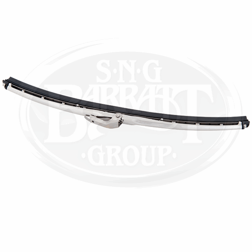

SNGB supply the good ones - part 8183, not 8183* aftermarket:
Cost is £16.29 + VAT compared to £7.43 for the crap one: https://www.sngbarratt.com/English/#/UK ... e3dd6dedf3
