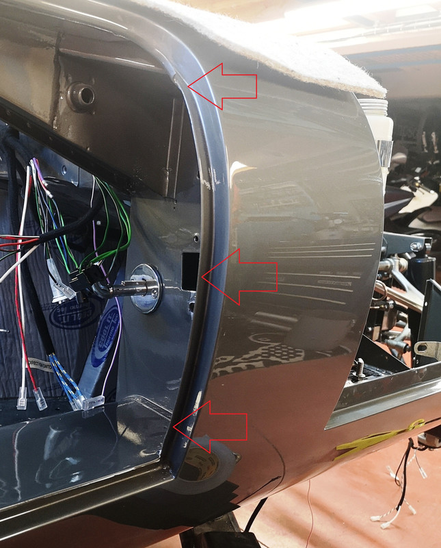

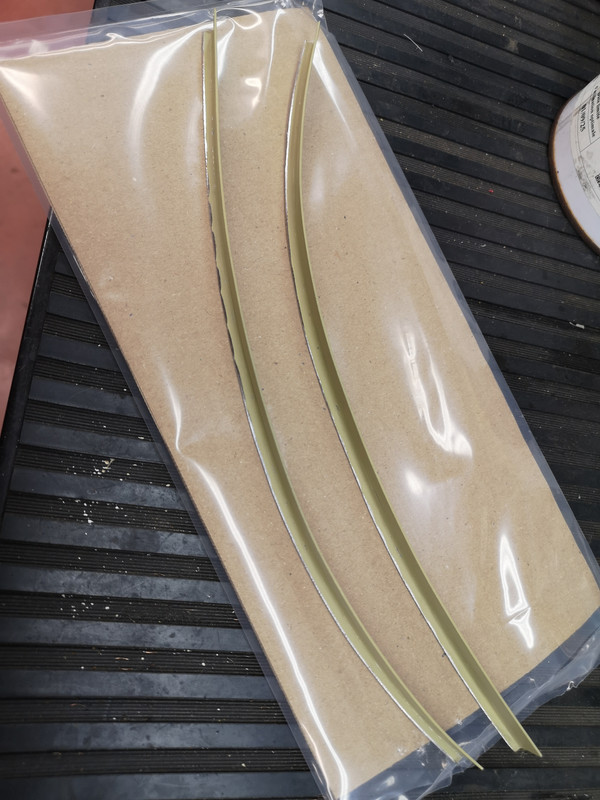

As I had some pictures from querying these retainers with Andy Raynor at Hutsons, I thought I'd add some to this thread as an intro to the question I want to ask.
I had been alarmed at the prospect that there might have been a channel that had been "forgotten" when rebuilding my scuttle area, and was mighty relieved to hear that they were added later.
Has anyone got pictures of exactly where they were riveted ?
How many rivets ? And I can't for the life of me remember which trim panel it is that covers them up ?
Do they have to be body-colour, or are they effectively hidden by everything once the car is trimmed ?
Is their lateral (ie fore-and-aft) adjustment super-critical, or is it just a continuation of the same channel width that is apparent at the top, and then continues along the bottom of the door, please ?

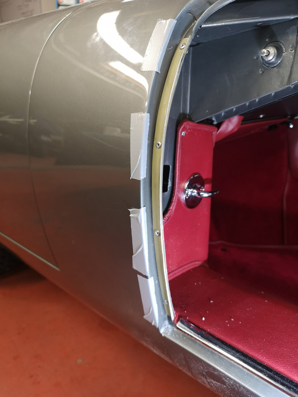

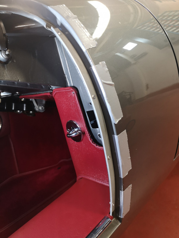

Post by Gfhug » Sat Dec 30, 2023 5:16 pm
Will these help?
I’d suggest painting them body coloured as you can see the edges which are not covered by the rubber.
And about 15mm from the wing to the aft edge, but not an exact figure all the way from top to bottom.
Certainly not a daft question.

Rory, as for rivets from inside, it would be difficult to get the rivet gun in place from outside, though not disputing your thoughts as these could well be replacements or what they did later on S2 vs S1. There are no holes showing to indicate they didn’t use the original rivet hole positions if they are new.
Hopefully the dimensions will help you decide how to place yours.
Now, go and wrap your car in cotton wool before Jeremy has strong words with you!

Thought I'd tidy up this post with some pictures of how I did it.
I decided that these parts were sufficiently invisible to not warrant a session of paint-matching, and settled for anti-rust followed by Hammerite in a rattle can.
I was able to get the rivet-gun nose in the channel space, I probably cheated by fitting a 3mm spacer between the nose and the rivet head, and settled for 4 rivets.
Their tips, and some zones of of the flat section, required careful relieving and re-shaping so that they sat better after the riveting operation - and didn't chew the existing paint - but overall the operation was far less painful than I had contrived to imagine.
