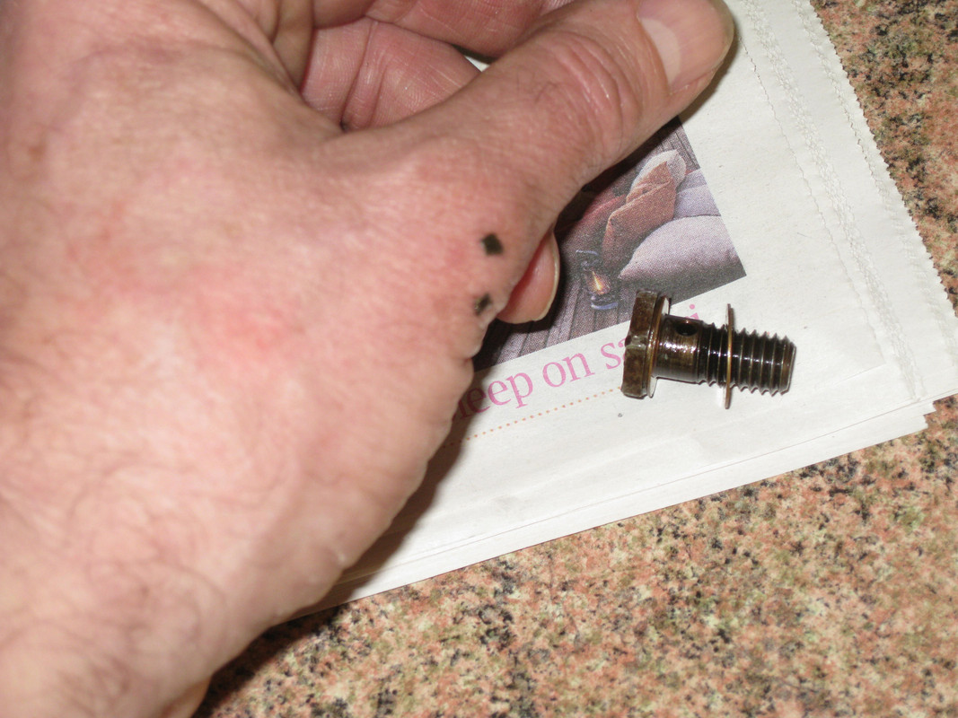

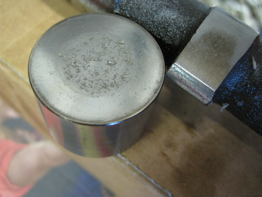

Many years ago my engine had just such a failure, It was caused by swarf, from an unrelated failure of big end split pins, blocking the cam oil feed pipe. Additionally, the break down in oil delivery trashed several of the cam followers.
This was the damage:
If yours looks like this, something is preventing sufficient oil getting to the cams.

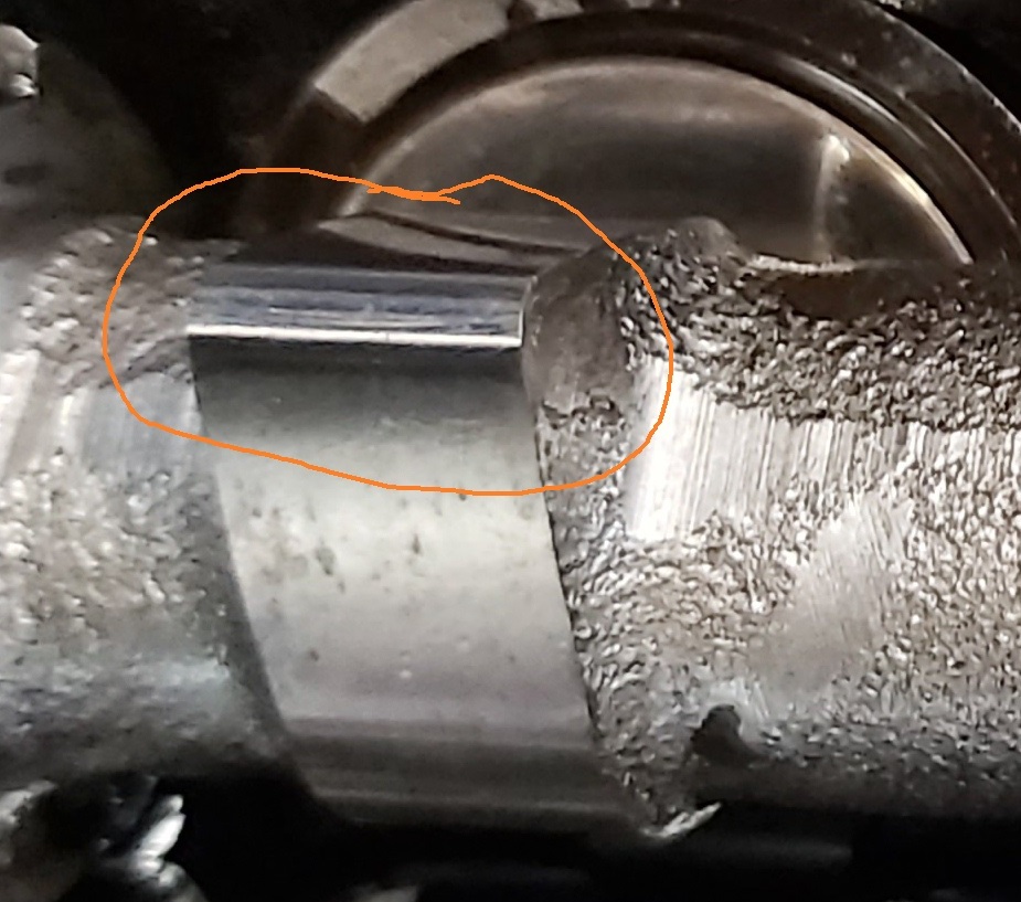

This is the problem, apparently:
The stripes are reported as evidence of wearing through the hardened layer. This is the only lobe on which such marking can be seen without rotating the engine. The cam is a S2 cam, groove on the flange.
This cam will be extracted next week and carefully measured to try to establish the amount of wear. I'm assured that a suitable solution will be found . . . this to be agreed, whatever it turns out to be

The damage on my car, which appears to be worse than yours, was only found some 13,000 miles after the event which caused it. The damaged cam was the exhaust cam, and I found swarf blocking that side of the oil feed pipe. It was actually in the banjo bolt in the cylinder head.
Damage included the camshaft, three followers and the camshaft bearings. All were replaced.
Once I'd found the cause of the wear, I was happy to replace the trashed parts.

Well, we came to the conclusion that there is little to worry about. I spoke also with our local engine machine shop which has years of experience refurbushing XK engines including cylinder heads and they cannot recall a need to replace a cam which has not been abused by lack of oil. Excess wear will most likely show most easily by wear marking on the cam followers - none visible.
So all my valve clearances were checked and it was closed up. The carb tune has made tickover much better.

There might be some wear to the hardening, question is: how much? Nobody seems to be able to give a definitive answer, it cannot be found by dimension measurement. Andy at Splined Hub worked on Subaru's in the States and would replace cams when such "evidence" appeared and has carried this through to the XK engine. We know how performance Subaru's are likely treated
Our opinion is to suck-it-and-see. I don't do huge mileage and so it's probably not cost effective to spend a lot on what might just be speculation.
