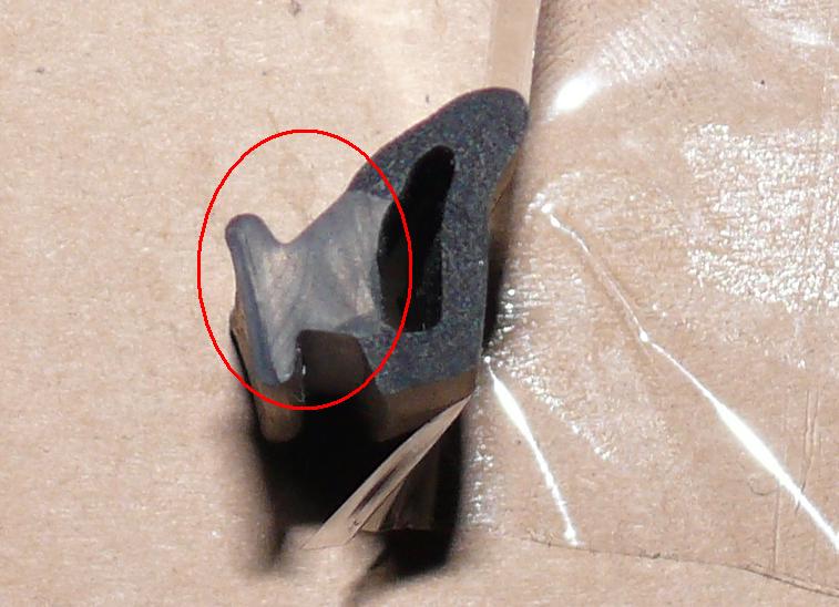

Following are the seal sections used in a 2+2. Don't be concerned that its labeled for a Series 3; they are the same for your car. The seal in the RH column labeled BD28434 is the correct section for the B pillar, but its the seal section in the LH column labeled BD20500 that's supplied by the usual suppliers.
The following pictures show the BD20500 section that's supplied as a B pillar seal. The seal in the pictures is made from two densities of rubber. The area circled in Red in the picture immediately below is quite hard, with the remainder quite soft. If you're supplied such a seal and install it "as is", you will end up with a door slammer for sure.
I've seen examples of this seal with the area shown between the Red lines in the next picture, cut out completely, so as to have the door close without applying unreasonable force. When you have to purchase a seal that's supposed to be fit for purpose and then have to mutilate it, its tantamount to buying a dog and then having to bark for it.
Therefore, I would check with whomever you purchase the seals from as to how the B pillar seal in particular is constructed. The seal in the above pictures was from SNG Barratt. I reported the matter to them, but I'm not sure if they have rectified it or not. This seal from XK Unlimited, now Moss, is made totally out of soft rubber and works.

If a complete kit, I would be interested to know if they supply the correct cross section for the B Pillar seal, BD28434, as shown in the seal cross section sheet I attached to an earlier Post, or do they supply the BD20500 cross section and label it as BD28434 like most of the other suppliers. If they do supply the BD20500 section, is it soft throughout, or constructed using two densities of rubber as shown in my earlier Post. If yes to the two densities of rubber, I suspect you will end up with a door slammer if the seal is installed without modification.

Sadly not any more it seems - although the Moss UK website clearly shows a fully foam structure seal, what I received today was yet another example of the extended solid rubber lower section type Bill shows in post#2 above and similar to those I have had from both Baines and SNGB over the past 4 years - all useless.
Hello Bob,
I really don't get why these after market companies make and sell such rubbish parts that just don't work. I have a lot of experience in Tool Making, particularly in all forms of moulding, and it would be much easier to make the seal using a single density of rubber. It would be a Win Win situation, where the cost of manufacture would be less (happy manufacturer/supplier) and the end user would have a workable, usable part (happy end user).
I've reported this matter in detail to the suppliers, but it seems it falls on deaf ears.
As mentioned in my earlier Post, to get the dual rubber seal to work, a reasonable chunk of the seal has to be cut and removed. It's just an abomination and a waste of money. I would gladly pay more for a part that worked, as most of what one receives now requires a substantial labor cost to fit.
