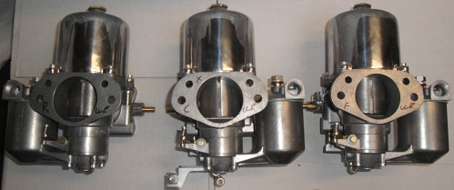

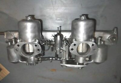

Hi Steve......I was unaware that 3.8 carbs could be found for less than 4.2......are you sure you are looking at the correct HD8 carbs...the ones you want have the choke adjust on the bottom of the carb(first photo)......there are plenty of cheaper HD8 carbs that do not have it and were from a set up that used an aed or starter carb unit..photo below has choke ..Steve
Still HD8 but use a seperate starter carb so no choke on bottom of carb
