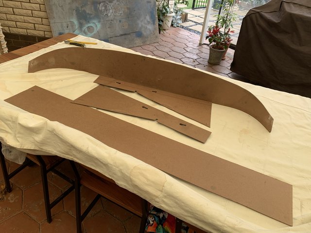

Bending MDF is fairly easy if you have a steamer, just an ordinary household steam cleaner. Steam the board, bend carefully then dry as quickly as possible. Living in a warm climate helps, but you can use a heat gun or hairdryer for the job, just go carefully. Try not to leave it wet for too long, because MDF will break up if it’s damp for a long period, but a few minutes has worked for me, making fairly complex shapes, such as the pieces above the rear arches of my E-type, similarly for my old GT6, the rear parcel shelf of my current project and various others. I’ve been told you can’t do it, but I’ve succeeded every time and I can’t remember ever wasting material. Once I did get a little separation as the back of one of the tighter curved pieces lifted and peeled, I simply allowed it to dry then stuck it back with PVA glue to get a very strong panel.

Thanks for that info, exactly what I was considering doing so great to know it will work

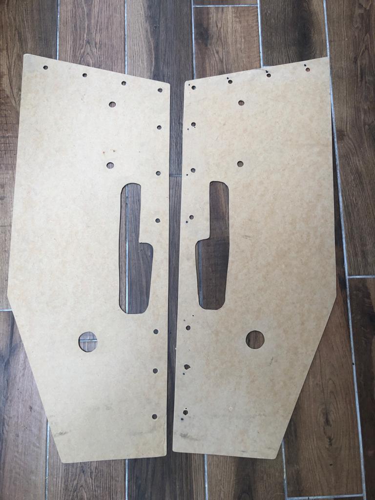

Well after much consideration I purchased a 8x4 sheet of 3mm HDF and have cut and finished the door cards, there are some extra marks on the right hand door card (for those eagle eyed
which look like holes) these are my marking out for the hole positions in the door itself. The remaining B post and rear arch cards have also been cut I just need to finish these once the car comes back on Monday from the paint shop
