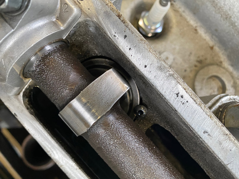

I'm slowly unpicking my fathers old restoration and was about to set the valve clearances and found two opposed screws on each valve seat insert?
I'm new to the XK engine but it feels like it's a hack from the company who "restored" the engine and rather than fitting the valve inserts correctly / using oversized seats they just tapped nuts in to hold the seats.
Has anyone seen anything like it and what would people recommend to fix?

It's to stop the seats moving.
It's been done pretty crudely, but you may as well leave them there.

I'm a bit anal so will probably get it sorted just so I can forget about it, is the common practice to machine and then fit oversized seats to make sure there's no movement?

Its not uncommon to see " hold down kits" fitted......iv seen quite a few like yours.....and the more common metal bracket holding the seats and bolted down.....depends what engine builder you use.....as Andrew said i would leave them......Steve

I googled the "hold down kit" and found your older posts / others so will take your advice and leave, just wish they were a bit less brutal :-)

Not being pedantic - but thats a tappet guide - valve seats are within the combustion chamber. Regarding repair as mentioned above get a tappet guide hold down kit ( if you are worried) and get a engine machine shop to fit it if you are not confident yourself. No big deal. If it works leave it.

It’s a valid, well-executed and unobtrusive modification, that requires equipment and skill beyond the capability of most DIY people.
No offence (well, maybe a teeny-weeny bit) but not recognising quality workmanship, naming the parts incorrectly, and calling that job a ‘hack’ is an insult to your dad and/or the mechanic who did the work. The only reason the parts houses supply plates and self-tappers is because that’s all the average Joe can be trusted with. I’d be proud to have that mod and it bodes well for quality work elsewhere.
I don’t know how many engines you’ve done, but since this appears to be your first XK, take your time, use the manuals and take care not to end up with a worse engine than the one you decided to ‘unpick’. You wouldn’t be the first.

Good call. And for the avoidance of doubt, I did try the Allen screw retaining operation myself once, but never again. I’m a plate and self tapper person too.
