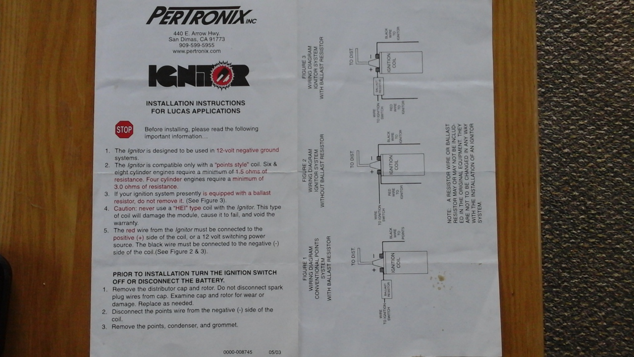

Steve, if you have pertronix, BYPASS THE BALLAST.......YOU WILL DESTROY THE PERTRONIX.
Your not getting full 12 volts.
Good luck
Just jump the wire......
Good luck

Hi Steve...great that your now working ok......however for anyone else searching a Pertronix can be used on Ballast systems...you need to wire it as per the instructions....Steve

Steve, This is so confusing as my pertronix instructions for a D177600 distributor states compatable coils are3.0 ohm and adds note: Remove or bypass external ballast resistor or resistance wire when installing the recommended flamethrower or HV E-Core coil.
I do note the instructions you show are for a 1.5 ohm coil so all I can go by is my set of instructions and the way the car is starting with my setup which so far is absolutely brilliant, starting from cold on the button every time. The moral here is I think , check which coil you are using.
Best regards Steve

Hi Steve...i see the problem....there are different "Pertronix".....the complete distributor unit......and the points replacement unit that fits in a standard distributor(Ignitor)......so different instructions depending what "Pertronix" your useing......Steve

With the 4 billion ive done or helped, overall for a replacement unit .
Using a 3.0 coil, no ballast in a series 2 and non copper spark plug wires.
Along with ngk plugs pre gapped 30-32ish.
Im in the camp that the 1-2-3 set up blows away the pertronix but if your comfortable with it.
The above set up is the most reliable and compatible
HAPPY YOUR CAR IS RUNNING SO SWEET, PLEASE RETIME THE ENGINE AND GET THE PLUGS, IT WILL TRANSFORM THE CAR!
GOOD LUCK
GTJOEY1314
P.S. THOSE directions are a little old,they have proven you need a FULL 12VOLTS or the unit strains and burns out.
The 3.0 gives enough resistance without burning the unit out with too much with the 1.5
3.0 overall is the best choice.
