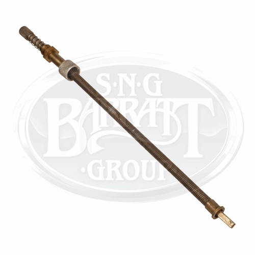

Should look like this:
Knurled knob is spring loaded as you can see and you rotate anti-clockwise IIRC to zero the trip.

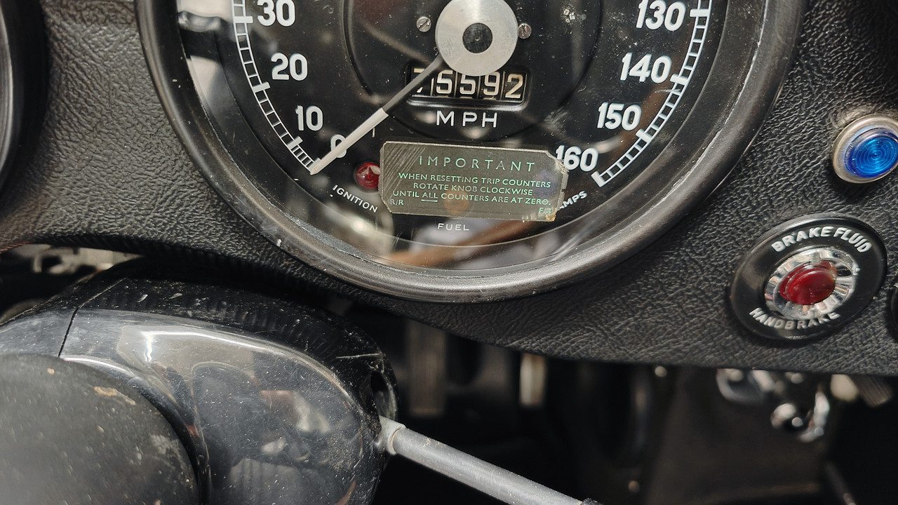

My series 2 is not like that - I have a plastic knurled knob with no spring. There's a sticker on the speedo that states to turn the knob clockwise to reset. No pushing required. Simply turn the knob until the trip dials all return to zero.

Ditto, though no sticker on the speedo. Maybe David’s info is for the S1 cars?Monkeyfinger wrote: ↑Sat Jun 25, 2022 5:01 pmMy series 2 is not like that - I have a plastic knurled knob with no spring. There's a sticker on the speedo

However page 19 says “The trip figures can be set to zero by pushing the winder upwards and rotating clockwise.” Though as Richard and I have found, no pushing just rotate.
Barratt’s show part no C26162, which is valid for S1 2+2, all S2s and S3s

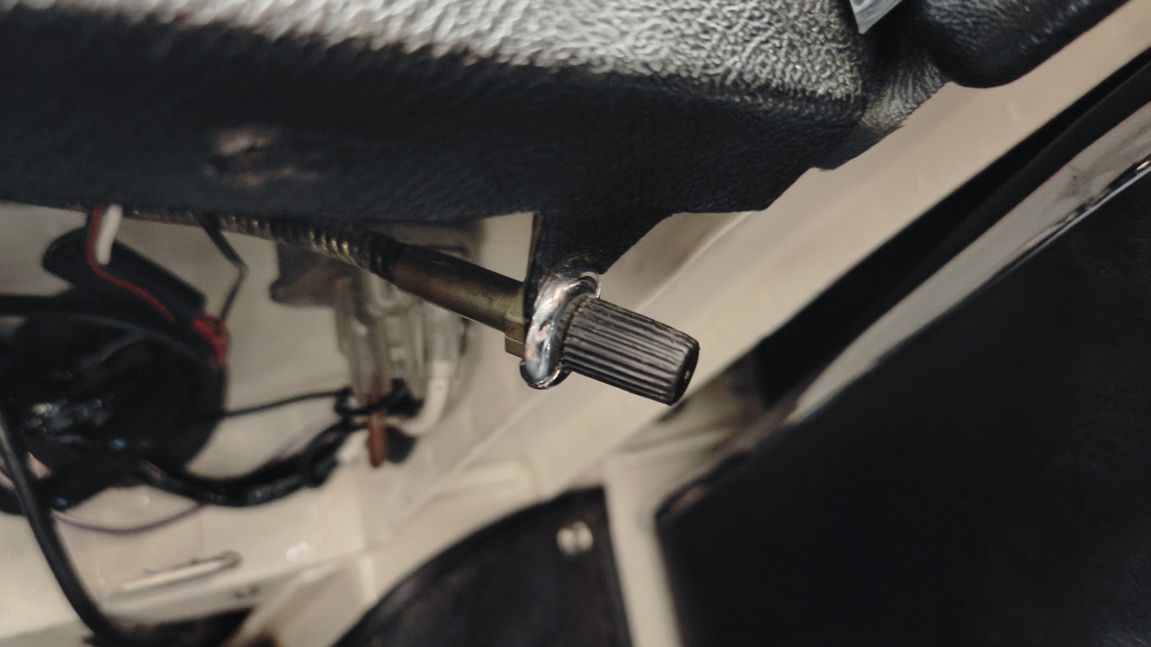

Just to add some (possibly) useful detail into this thread. Here's a picture of my speedo sticker, lovingly applied to the instrument some 54 years ago in Coventry, and has resisted all urges to remove in the intervening years. Also one of the end of my reset cable - all original for a 1968 built S2 as far as I know, and certainly unchanged in the last 45 years its been in our family. It also is positioned exactly where the cutout is for the cable in the underdash millboard panel.
Interestingly, my Series 2 parts book shows the cable assembly as part number C26162 - a number of suppliers show this with the spring loaded end, but SNG show it as matching my car setup with the plastic knob for rotating only. They do show C15468 which looks like the other cable mentioned in this thread, but is listed for a S1 only, not a S2. No idea why a S2 would have this part fitted unless speedo was changed for an S1 item, and I don't even know if that's a done thing...

S1 = C15468
S2 = C26162
S2 = C26162

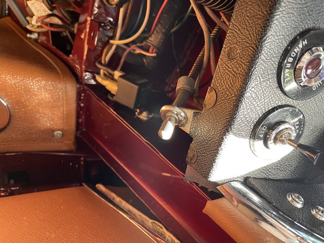

Thanks everyone for your input. Very helpful. May car was built very late in '69 registered in early '70.
My speedo face has the numbers SN-6332/08 1120 with a small sticker on the back showing 089.
I've attached a photo of my reset knob. The knob has very little in and out movement particularly when connected to the speedo and there is no space to fit a spring so I'm guessing it's as it should be. The square drive at the speedo end is permanently engaged with the reset mechanism input shaft, so as you've said just turning clockwise until the counters all read zero? Just sending my speedo back to the repairers for the second time. I think I've just been doubly unlucky. Fortunately the Royal Mail office is a 5 min walk away.

Andy - looks like we have the same speedo based on the numbers Geoff quoted, which match mine and yours. On that basis it should be twist to reset. I think you may need to twirl it a few times until they all read zero and you win the jackpot...
