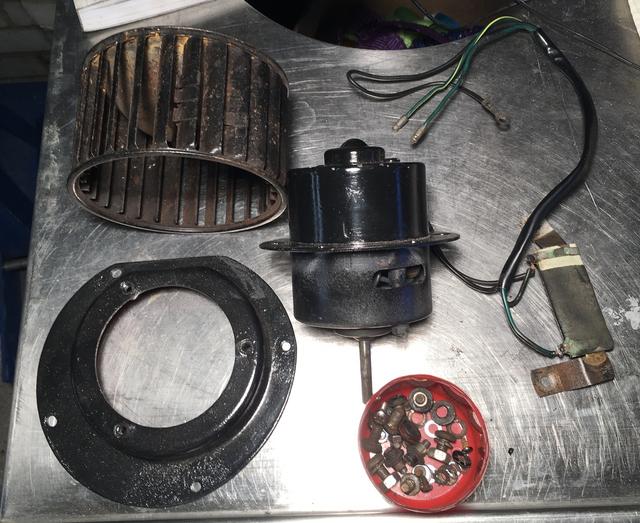

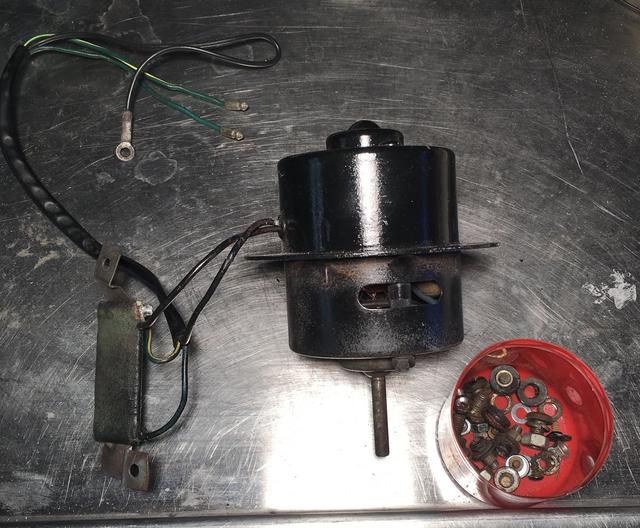

#8 Re: Heater Resistor
Here is an original S2 motor and ancillaries:

#9 Re: Heater Resistor
Thanks David that looks the same as my damaged resistor so it does look to be the original. Have now purchased the replacement smaller cylindrical type from SNG which has different fixing so need to work out the best way of mounting it.
